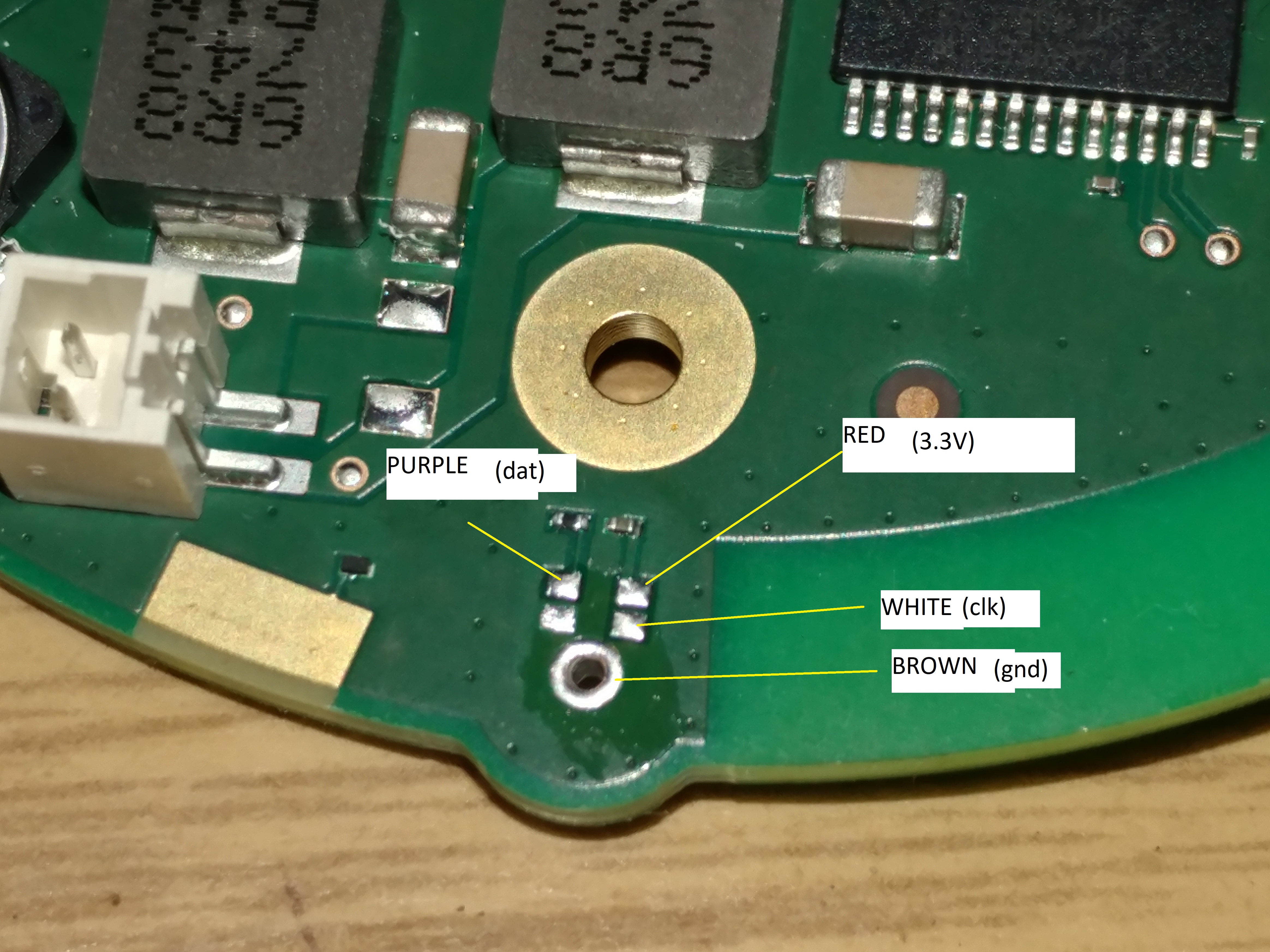

Step 1:
Disassemble the home mini to access the main circuit board. Use this guide: https://www.ifixit.com/Teardown/Google+ ... own/102264
Step 2:
BE SURE TO REMOVE BOTH MICROPHONES!
You can destroy them, we won’t be needing them anymore.
Be careful not to contact or remove the tiny components near the microphones!
On your Hot Air Station:
Set the temperature to 350 and carefully desolder both microphones. It should slide right off.
With Your Heat Gun:
Heat the microphone area locally and check if microphone is loose every few seconds. It should slide right off.
Step 3:
Strip a bit of rubber and tin the red, purple, white and brown wire.
Step 4:
Solder the wires to the pads as shown, careful not to have any shorts. It doesn’t matter which
mic’s pads you solder to, just make sure to connect them as shown.
Figure 1: Home mini circuit board after microphone removed.
Step 5: Optional but highly recommended
Strain relief the wires by taping them down to the circuit board, bending them over and taping again. You can also use a dab of epoxy or glue but test first to make sure it’s working.

Solder the other ends of wires to the google home mod kit.
Step 9: Very important.
Triple check all connections. If you are not 100% sure you connected it as instructed, send me a picture of your work and I’ll check it for you.
Check all connections with a multimeter on continuity mode. There should be no continuity between the wires.
Step 10:
Reassemble the home and plug it in. You should see a red LED on the mod kit light up about half way through boot up.
