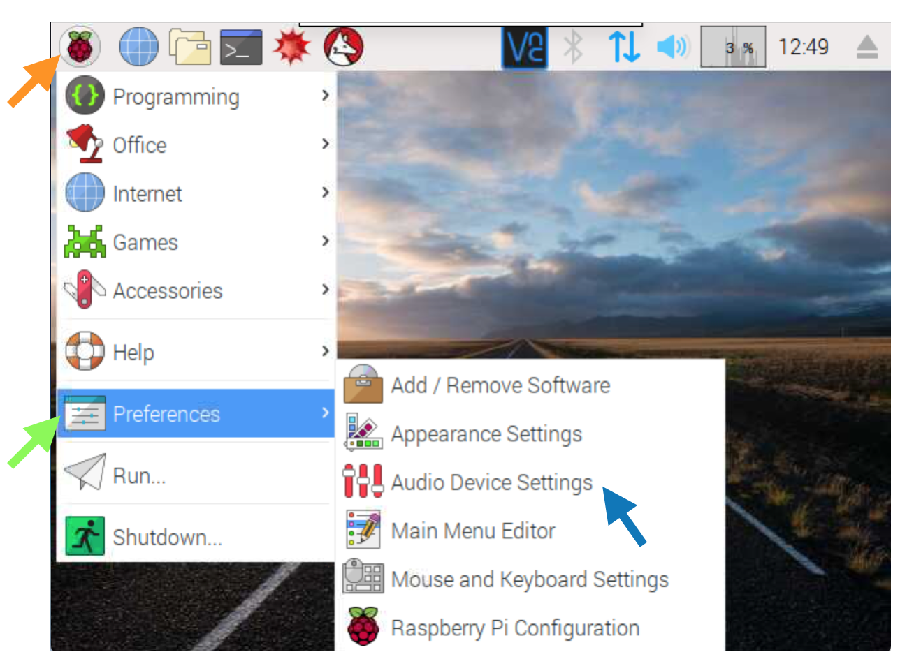

- Go into the Audio Device Settings by following the orange, green and finally blue arrows in screen shot 1 below

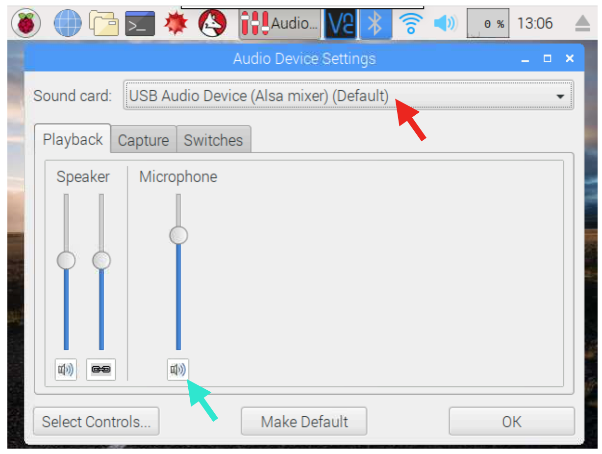

- Verify that the USB sound card is selected from the drop down menu on the window that has just opened, this is shown by the red arrow on screen shot 2.
- Click on the speaker below the microphone slider, shown by the turquoise arrow on screen shot 2. This will re-transmit the audio from your microphone out to the Google Home. If this worked you should now be able to listen to the microphone if you plug a pair of headphones in where the Google Home's AUX is connected. Use the sliders to adjust the audio levels so that the Google Home can hear you properly.
