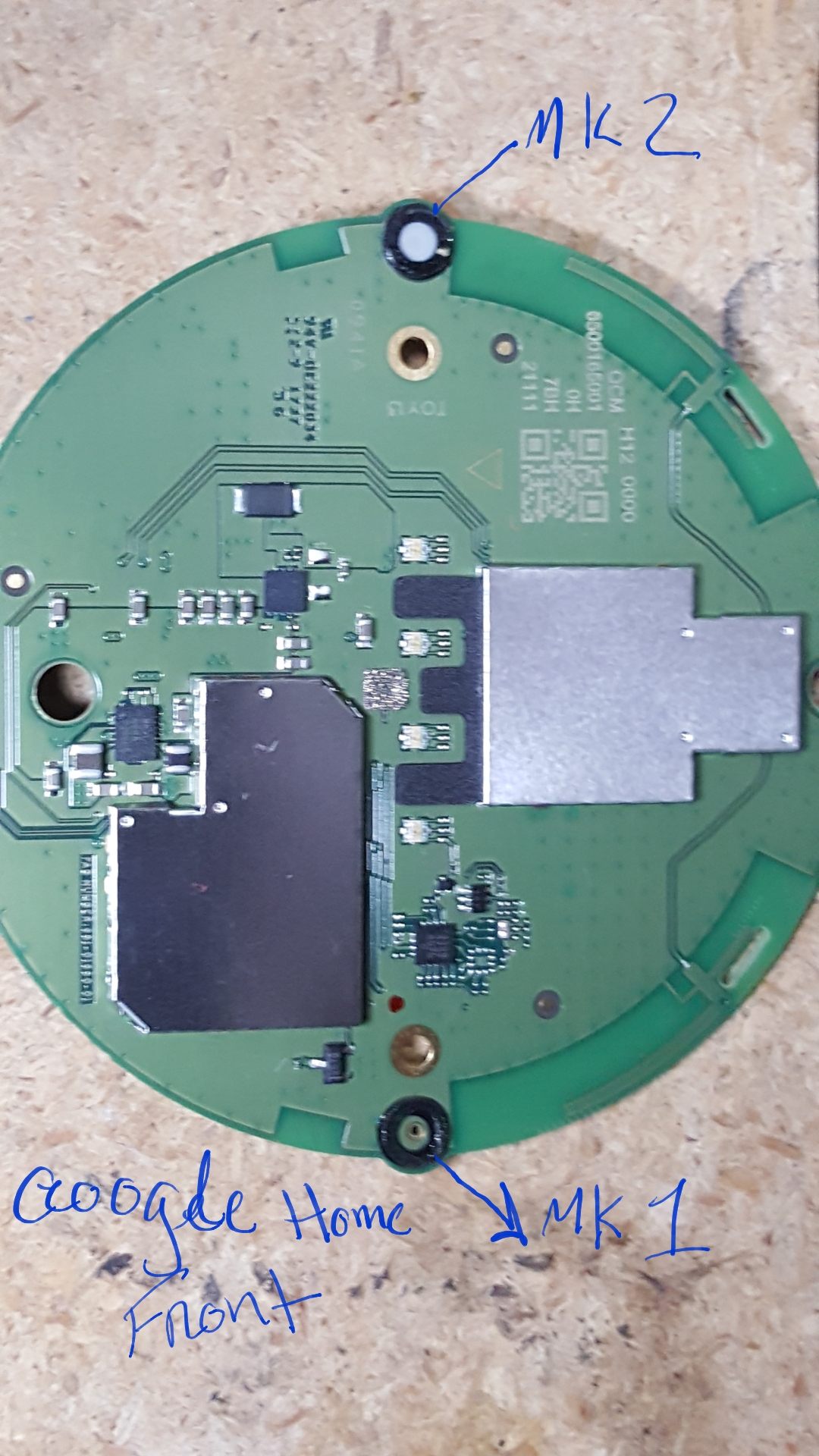

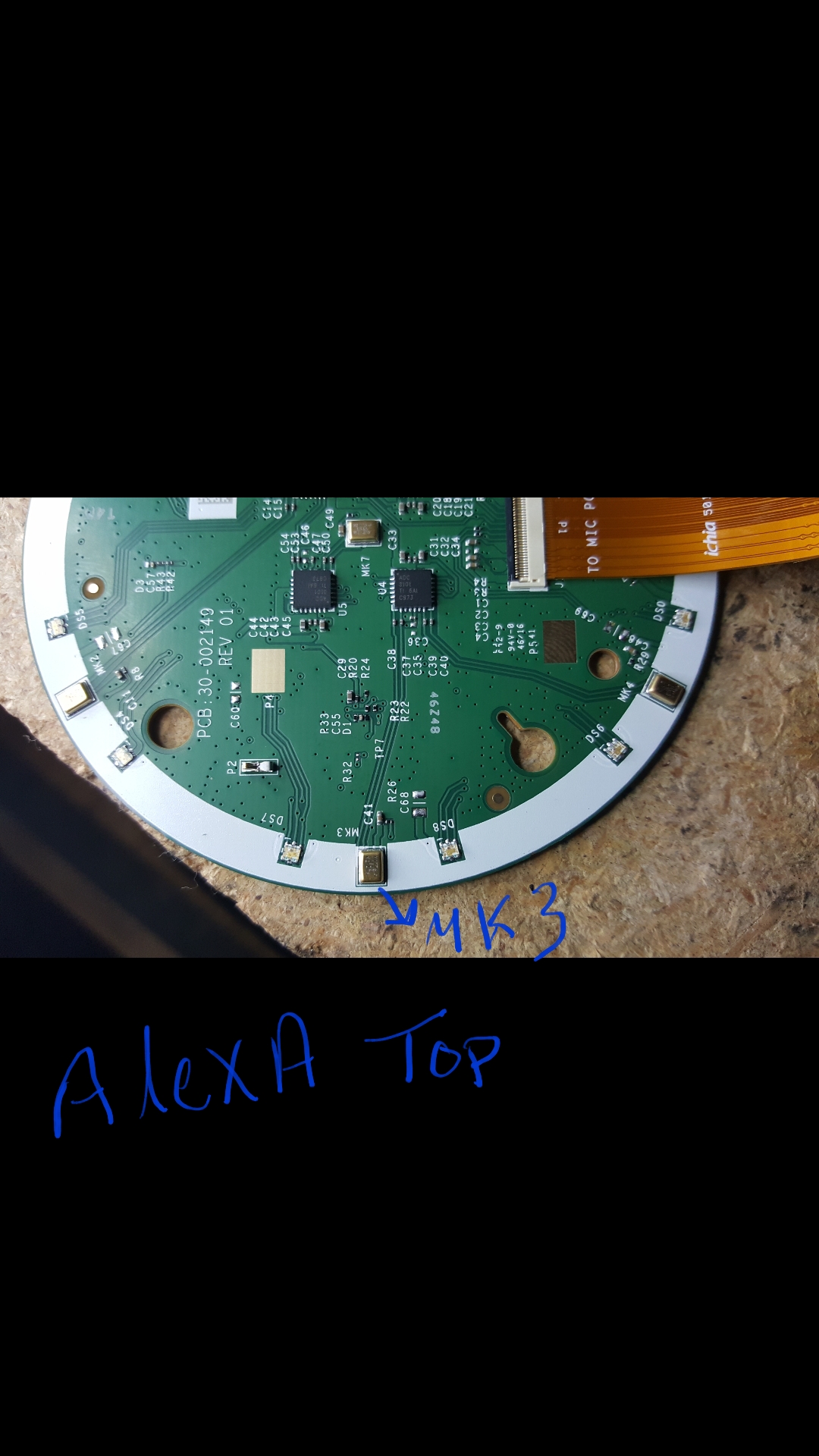

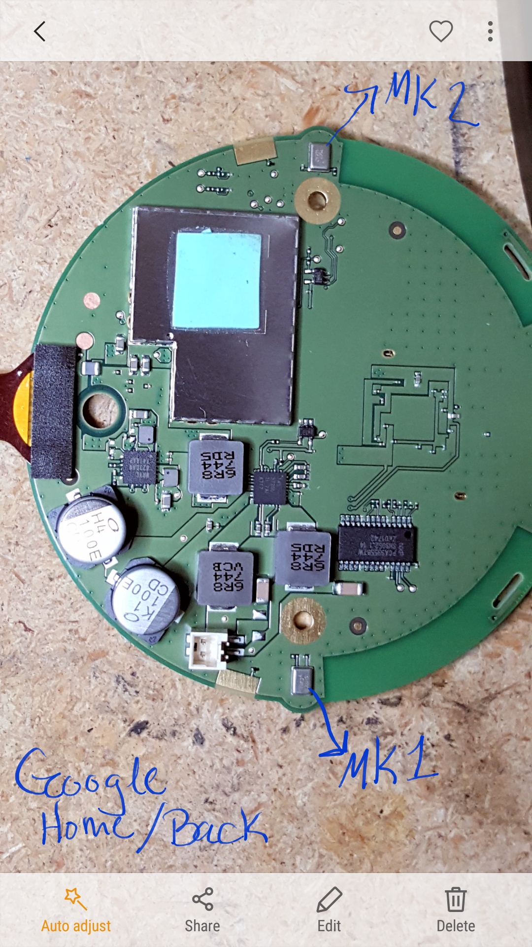

Hello my name is bernie, thank you for your time. I have attached two pictures (Front and back) of the Alexa dot and google home. I am looking for a method to be able to tap into their circuit to add my own digital I2R signal. The problem im facing is that all of my wiring gauges are to big to tap in to the circuits. Would appreciate any input you may have.
Ps: Im not even shore this may be possible with out destroying the board with a soldering iron.

Re: Project: Add external microphone to Home Mini
Hi Curt. We are taking a similar approach. We will de-solder the microphones with a hot air station and tap into the signals with small wire. It is doable, with the right equipment. I don't suggest you attempt this if you don't have hot air ability.
PS. Those are some nice pictures.

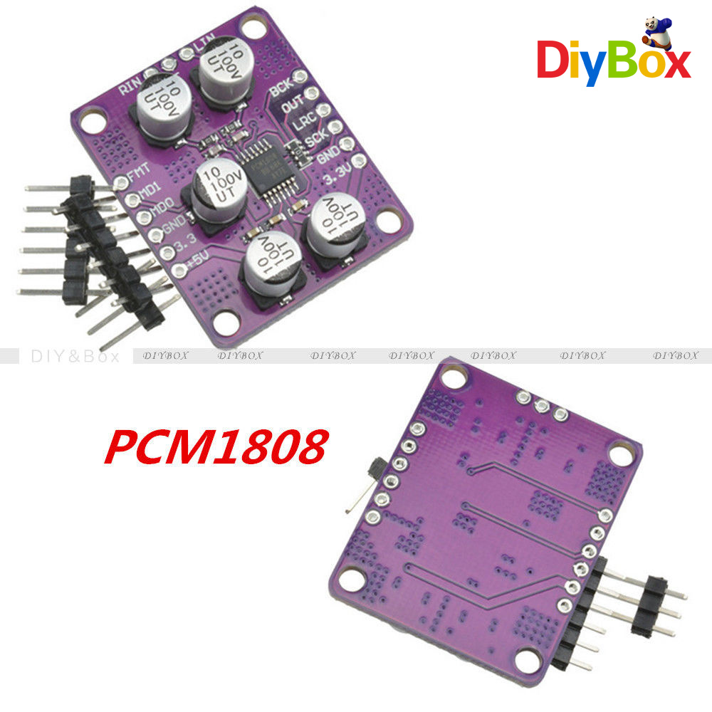

On my end, I bought the ADC analog to I2S breakout boards a few days ago, now it's a waiting game until they show up.

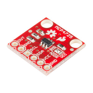

thanks, we were actually ripping apart analog digital converters, but the breakout board is a not cleaner of a solution. Do you think this one will suffice? Seems to be cheap. ~$5 dollars. http://www.kr4.us/Breakout-Board-for-MC ... gJi9vD_BwE
No that won't work, that is an Digital-to-Analog converter (DAC), so more for analog signal generation. And even then it's not really suitable for audio (and incompatible with home mini and echo) since it's not I2S capable.curtdissel wrote: ↑Mon Feb 05, 2018 11:37 pmthanks, we were actually ripping apart analog digital converters, but the breakout board is a not cleaner of a solution. Do you think this one will suffice? Seems to be cheap. ~$5 dollars. http://www.kr4.us/Breakout-Board-for-MC ... gJi9vD_BwE
I ordered this:
https://www.ebay.ca/itm/112679662396

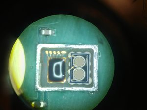

So David and I took apart the mini and desoldered a microphone. Here's what that looked like
By taking the microphone off we were able to identify the model number by comparing the various datsheets to the PCB footprint.
Turns out we were wrong about the microphone being i2s, it is actually a PDM microphone. PDM is a digital signal where a high frequency pulse density represents the frequency of the audio wave.
We verified this with the oscilloscope and saw the PDM waveform.
Now we need a way to convert a line in signal to PDM. From our research this far, we were not able to find an IC that does this. The closest thing we found is an electret Mic preamp which is not ideal but should work. We would take the line in signal and divide it using a voltage divider to get the millivolt signal expected by the preamp.
David is looking into alternative solutions.
Stay tuned.
Stay tuned.
