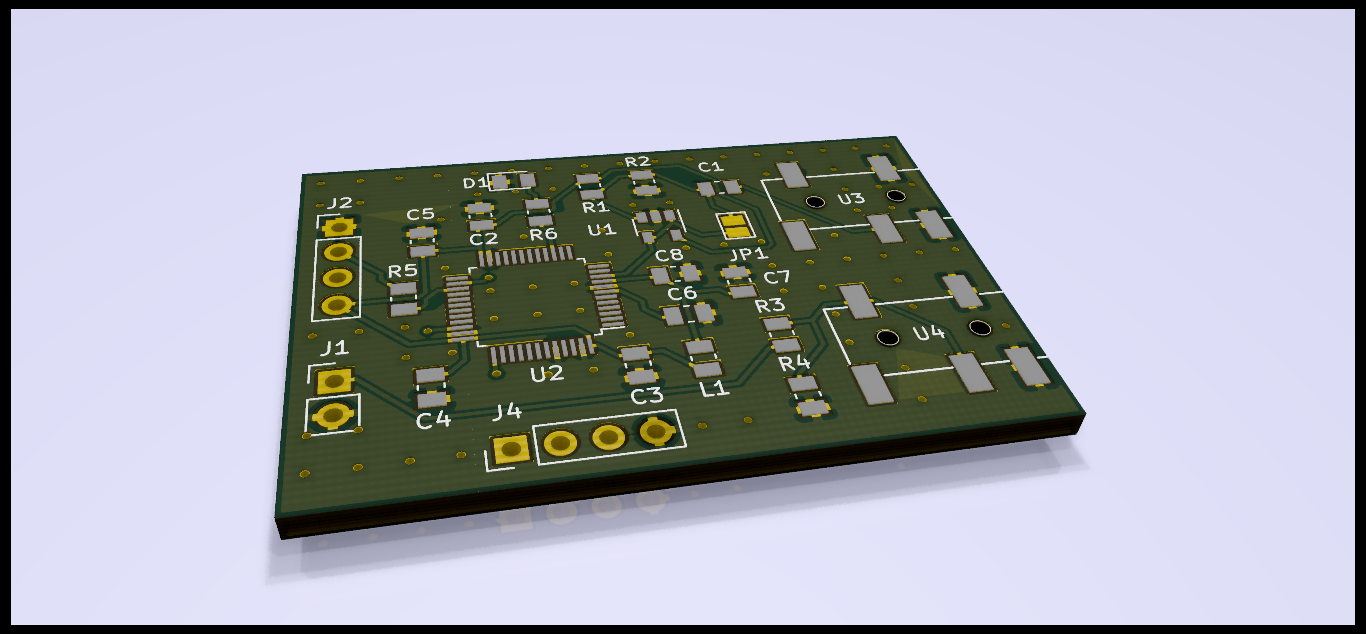

We've been working on increasing voice recognition accuracy and consistency. There was some interference and noise in the audio, partly caused by imperfections in the software, partly caused by audio front-end. Now it seems to be 95% as good as the original voice recognition. We are working on the circuit board which is the brains of the kit, it's basically done. Here is a render:
The board will come assembled and all you need to do is wire it into your home / home mini.
In this state, the software is good enough to ship. Last step is to get the circuit board made and send it to all people that pre-ordered.
Thanks for your support. Especially Curt Dissel.
