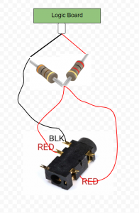

Would this be the correct diagram for the basic mod:
https://docs.google.com/drawings/d/1zv3 ... sp=sharing
Posts: 237
Re: Aux Out Only
Yea that looks good. Connect the red wire to both "RED" terminals.

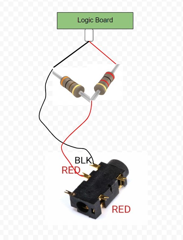

You mean I need two red wires going from the resistors - one to each terminal labeled RED on the Aux out like this?
Posts: 237
Re: Aux Out Only
Yes exactly
