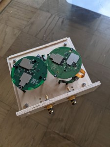

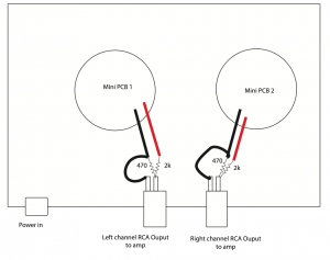

I'm trying to create a little stereo (2-channel) google mini device. Rather than having a mono aux out, I have two Google Minis that I'm pairing for stereo output (this thing) and then outputting via RCA ports, through to an amplifier, and then on to a pair of passive speakers. I've fully removed the mini speakers in favor of the 2 channel RCA output.
My question for you is the wiring. I've attached a wiring image with my plan. Does this look right to you?

Picture of project:
Wiring:

Hey Ted, looks great. Watch out for ground buzz issues, you may need to experiment.
