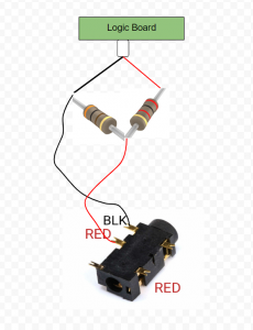

i am outputing this into an amplifier that feeds 3 pair of in ceiling speakers. I can only get this to play out of the left speakers. Is this mono only?

The home mini only outputs mono, but the wiring instructions show how to split the signal so it becomes "stereo".
How did you wire the plug? If you post a picture of the wiring I can help more.

To split it to be stereo, do I have to connect the Red wire to both RED points, or only one as the attachment is good enough?
Re: Not getting stereo out
Connect to both to get stereo
