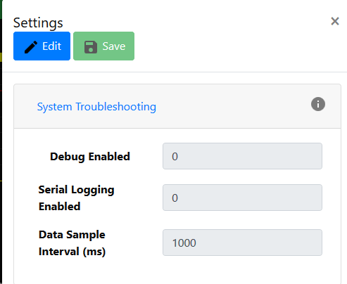

xion2000 wrote:
Sat Nov 21, 2020 5:50 am
I've been having problems for several weeks now after have none at all for several months, the data collection is being rather hit and miss. I upload my data to Home Assistant which displays a graph similar to that on the SolarDashboard and I use that data to turn on & off a battery charger. I'm getting gaps in the collected data all the time so rather than displaying a graph as a continuous line is is made up of dots and spaces.
I actually think the problem is the Epever Charge controller not the SolarDashboard as if I switch monitoring to my PC using the Epever Monitoring Software I'm now getting communication errors when trying to read data every 10 seconds (which used to work fine) but appears to be OK if I change to a read frequency time off every 20 seconds.
Is there a way to adjust the read interval time on the SolarDashboard
Is anyone else having similar issues
@xion2000, yes it is possible to update the read frequency for the SolarDashboard to be longer using the "Data Sample Interval" settings under "System Troubleshooting", current default is 1000ms, you can change it to a longer interval and try.
