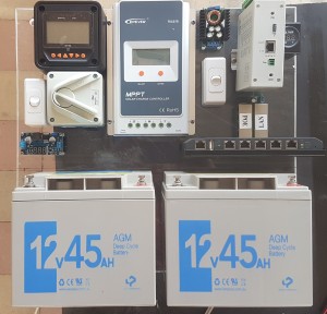

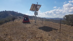

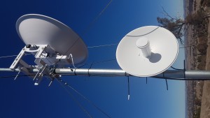

I have received my solar dashboard which is to be incorporated into a solar powered wireless relay stations upgrade running ubiquiti gear, as this setup uses 24v battery (2x 12v batteries in series) setup I am unable to show the battery voltage that only peaks at 16v on the web interface, is there anyway of getting the code to show up to 32v in the battery graph and dial

Hi Ross, Amazing setup, thanks for sharing.
I had some time today to work on the software and I attached a modified software for your use in your sweet relay.
