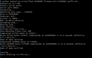

Hi Ross, I've just confirmed you shouldn't need to enter bootloader mode at all, just unplug the 2 jumpers and connect the USB port. Make sure there are no other COM port devices connected to your PC.
Then run the esp-tool command and the ESP should be automatically detected and load the firmware.

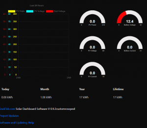

See success screenshot below:
Hi Ross, I just downloaded the firmware and flashed it using the esptool.py, and it's showing your custom firmware.rosspeel wrote: ↑Mon Oct 21, 2019 11:07 pmMuch appreciated, as i have another 24v system playing with.

Can you try to use the esptool to erase the flash:
Code: Select all
$ python esptool.py erase_flashand then program the firmware again. Make sure to extract the spiffs and firmware file into the esptool directory:
Code: Select all
$ python esptool.py write_flash 0x000000 firmware.bin 0x300000 spiffs.binBelow is screenshot of what your custom firmware looks like:

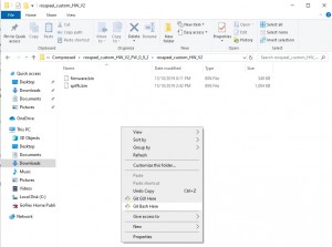

I have installed Bash, and when i run bash i can get a drop down box when i right click the mouse

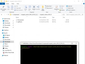

then get a box

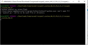

Then i input esptool.py write_flash 0x000000 firmware.bin 0x300000 spiffs.bin
but get an error back

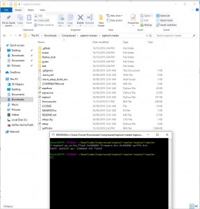

I have also tried placing all files inside the C:\Users\Owner\Downloads\Compressed\esptool-master\esptool-master and also include the to firmware bin files without any luck
This where anyway of doing a youtube video of how to setup the software and flash and update in a good step by step for windows dummies?
Try adding "python" before your command like I said below:
If it gives you an error like "python not found" you may need to install it and/or add it to your environment variable PATH. Plenty of help with that if you google that.jonathan wrote: ↑Wed Oct 23, 2019 2:32 am

Below is screenshot of what your custom firmware looks like:ross_peel_solar_dashboard_screenshot.PNG
You can check for Python path being set up correctly by just typing Python

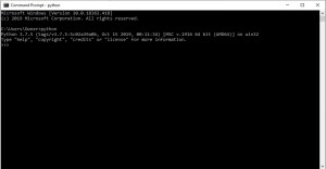

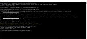

I think i have worked out getting Python going, when i open up CMD prompt and type in Python i now get a reply

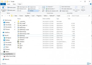

I found a Youtube video on installing esptool.py
https://youtu.be/p4UGKRKYFCs My Python script directory after install has the esptool inside it now after install But when i open Bash in where the bin files are and try and erase or upload the bin files i still get an error Any advice on what i am doing wrong would be helpful
