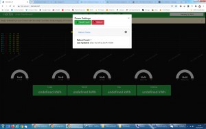

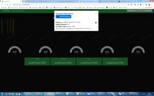

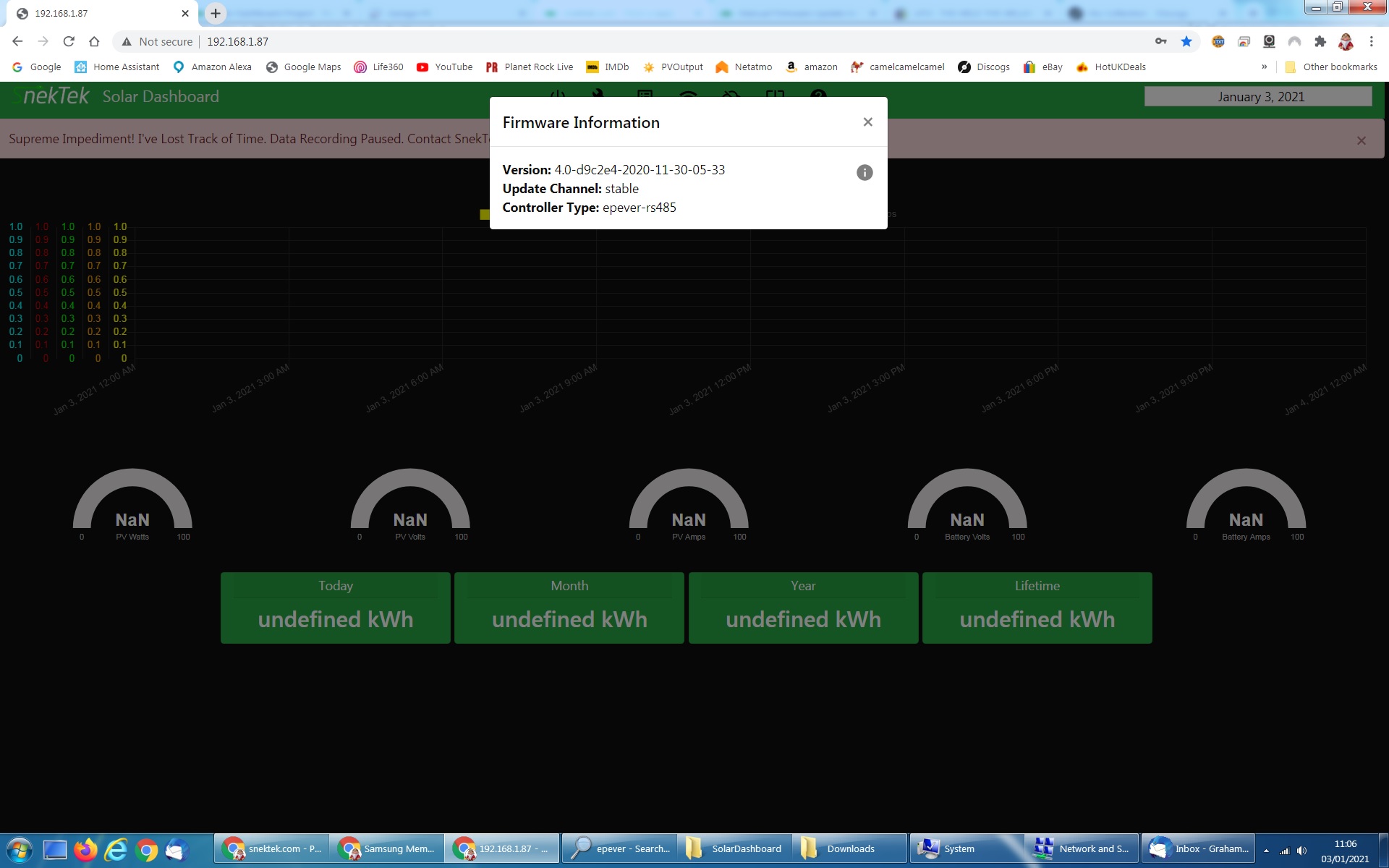

Reflash done & online update done.

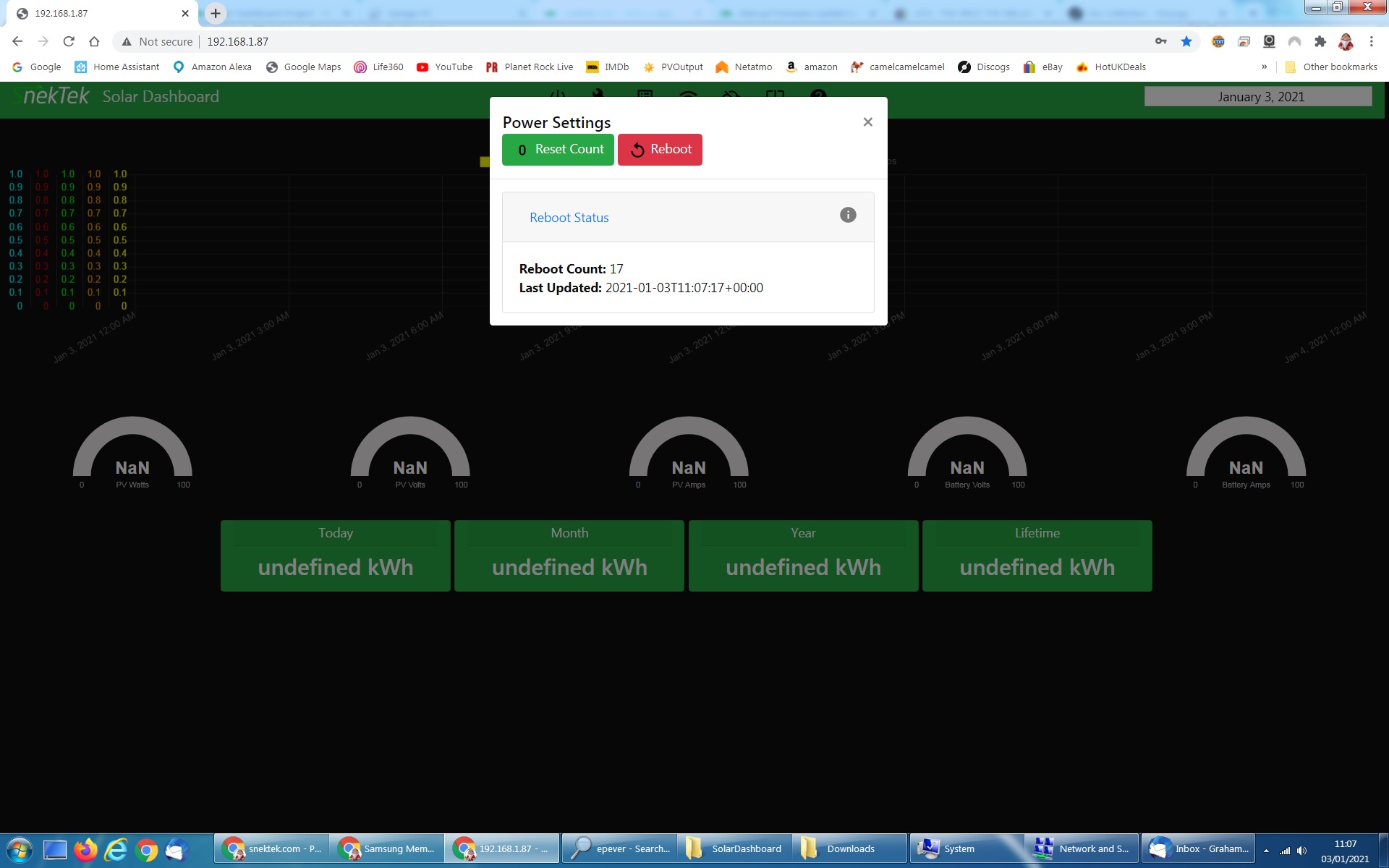

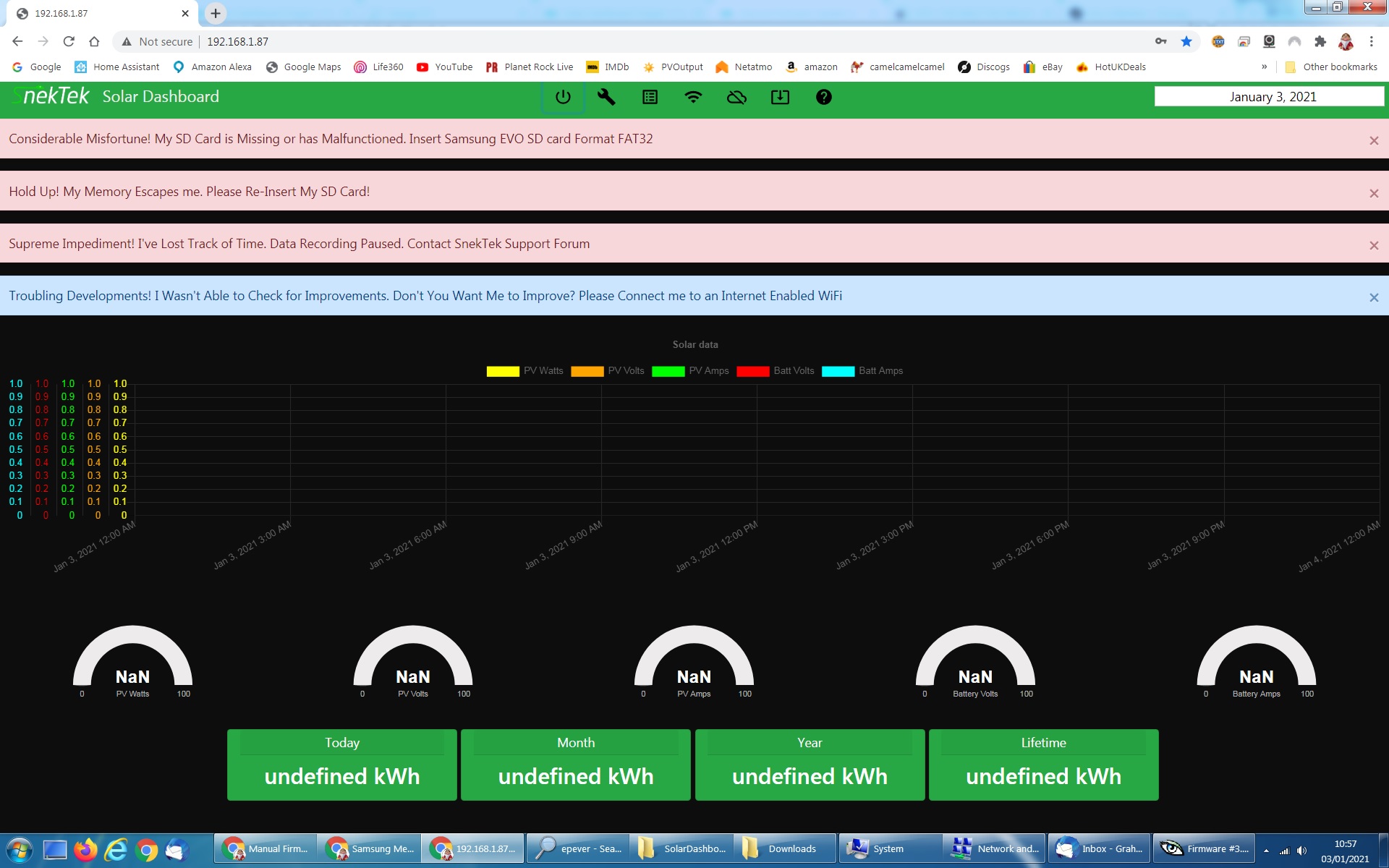

Unit still reboots every few seconds with or without memory card installed and with or without a connection to to charge controller
