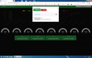

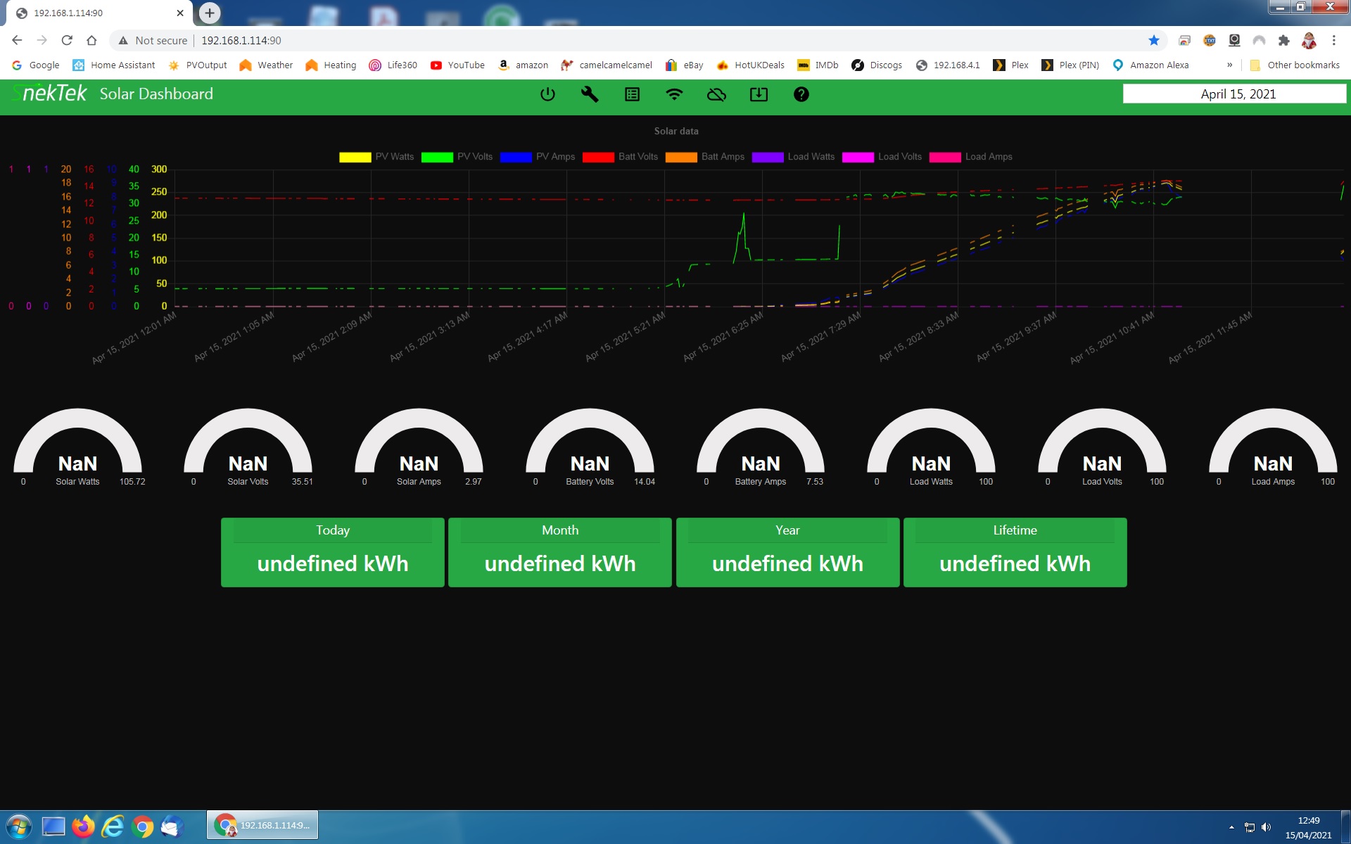

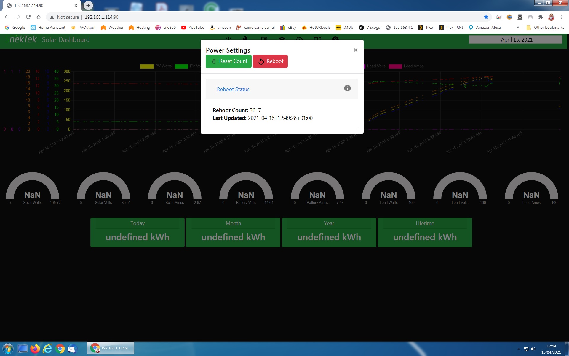

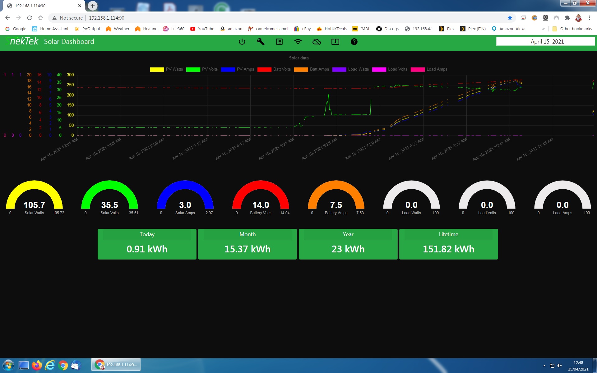

Can anyone suggest any reasons why I constantly suffer with the problems identified in the images (screen grabs) I've attached
This is a brand new device from Jonathan with the latest version of hardware & software.
Since setting it up the other day the reboots are getting more frequent & the gaps of missing data are getting longer.
If I connect to the Solar Controller with my PC and run the stock Epever monitoring software I have no issues

Yea so this is very obvious what is happening. You're on the right track.
The way the dashboard works internally is there are various tasks that must be accomplished, kind of like a repeating schedule. Some of these tasks, it's not clear how long they will take and can take longer depending on external factors. For example, if the WiFi connection is weak, it might take longer for the cloud server or mqtt broker to respond, extending the length of time it takes to do the task. I'll give some examples of scheduled tasks:
- Collecting sample from solar controller
- Averaging the last minute's samples and writing to SD card
- Checking NTP server for time
- Publishing to mqtt, if enabled
- Checking in with the cloud, if enabled
- etc.
Then there are events that must be handled as they happen, such as data update from an open web browser session. These can interfere with the tasks and take time away.
If there is not enough time to do all the tasks according to the schedule, some tasks will be skipped until the next time the processor is available.
There is usually enough time to do everything, in theory, and the programming can try to prioritize certain tasks to make it not noticeable.
From your charts, you can see that either task 1 or 2 or both are being delayed by probably the mqtt task so there are larger gaps in some of the data. Can you post your logs for these days on the forum?
