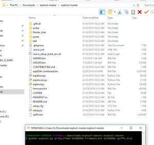

But when i open Bash in where the bin files are and try and erase or upload the bin files i still get an error
Any advice on what i am doing wrong would be helpful
Ross
Instead of "installing" esptool, try this:
Unzip a new esptool-master folder.
Put the 2 firmware files inside
Run the bash command from inside this folder.
See screenshot of my setup:

your worth more beer Jonathan, finally worked it out
One error i came across was
CODE: SELECT ALL
$ python esptool.py write_flash 0x000000 firmware.bin 0x300000 spiffs.bin
By SELECT ALL i was carry across an extra $ into the window prompt of Bash, once i removed that all went well
thanks for the persistence with me

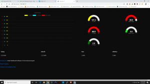

All has been running well since the upgrade to 24v Battery setup, I am running LifePo4 batteries in series of 8, just as thought, because my battery must keep over voltage at no more then 28.6 volts and a low voltage of about 22v, (hopefully never get that low).
Just a idea.......Be nice to see the graph on the left hand side be scaled different, a scale from 22v to 30v so as to see steps in one volt steps.
With thanks Ross

Hi Ross. Are the other graphs ranges good for you? Probably the watts graph can be changed too. And the panel voltage.

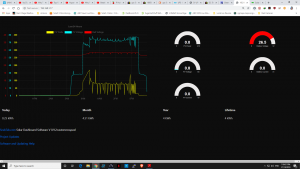

Hi Jonathan, my setup, the voltage on the panel is just top out at 80V, my panels are rated at 45 volts open circuit each and while my graph doesn't get to 90v because there is alway a slight load on the panels, what would be handy is the wattage on the load side, if i could be worked out a Plus-Minus graph on the battery, that way i could tell if the battery is in charging or discharging state in relation to the load (Bit like a amp meter minus 20-0- plus 30 meter but in wattage).
The graph below is the last 24hrs of use
Just another thought, the semi circle charts if they could be grouped closer together and allow more room for the main graph, also at the same time could it also grow taller.
Thanks Ross

Today i had the web page shake like in Adam Welsh you-tube video, it was only when i resized the page that it went away, there seems to be at certain sized window that this happens with, it maybe the browser problem?.

Yes, this happens at certain window sizes. Best is to avoid the size where this happens. V3 software may fix this.
