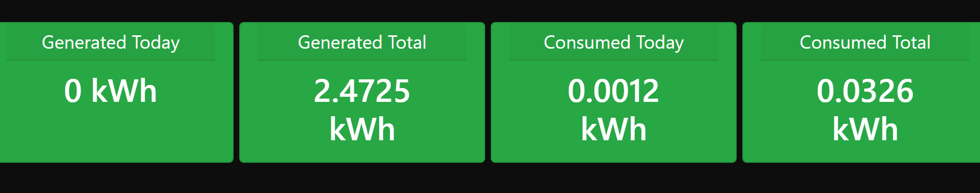

- I have added a Fahrenheit conversion option it should be available in the latest edge firmware. See if you can find it.
- Renogy does not have a month generation total, however they have consumption stats for day and total, so I have added that. I am still not exactly sure if the numbers are correct, I have to get a BT-1 dongle to check. In the meantime check it and let me know if it makes sense.

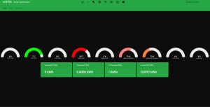

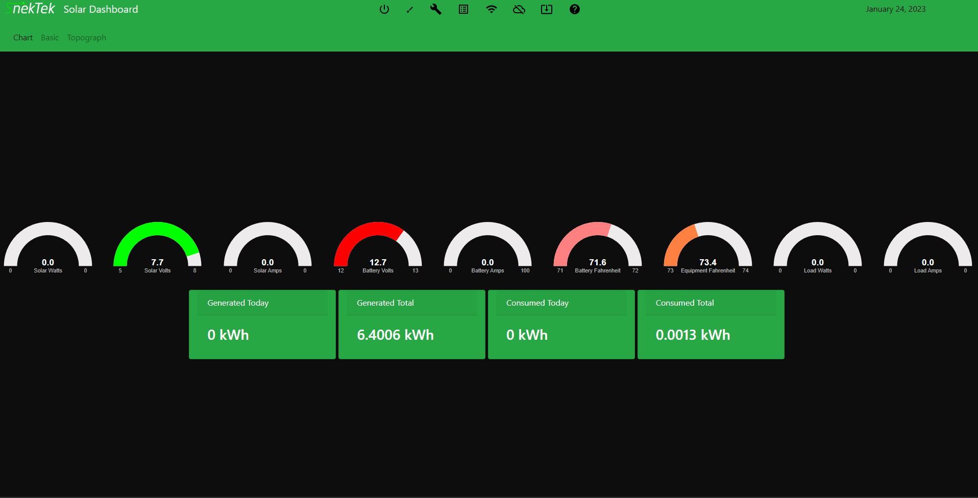

I see 5.0-7595fc-2023-01-22-20-59 and updated and now see Fahrenheit option!
I also see some data in "generated total" and "consumed Total" Will see what happens today but also noticed the graph is missing? how do i display the graphs again?
Hmm it's working for me so this is interesting. Can you try holding shift and then refresh? Also try pressing F12 and refresh, look at the console logs. What browser are you using?
yeah was just a cache issue.
