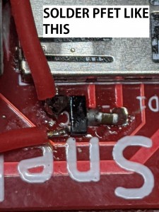

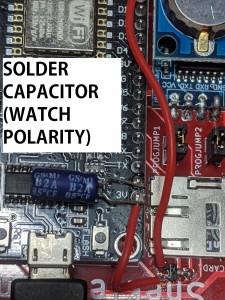

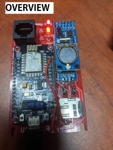

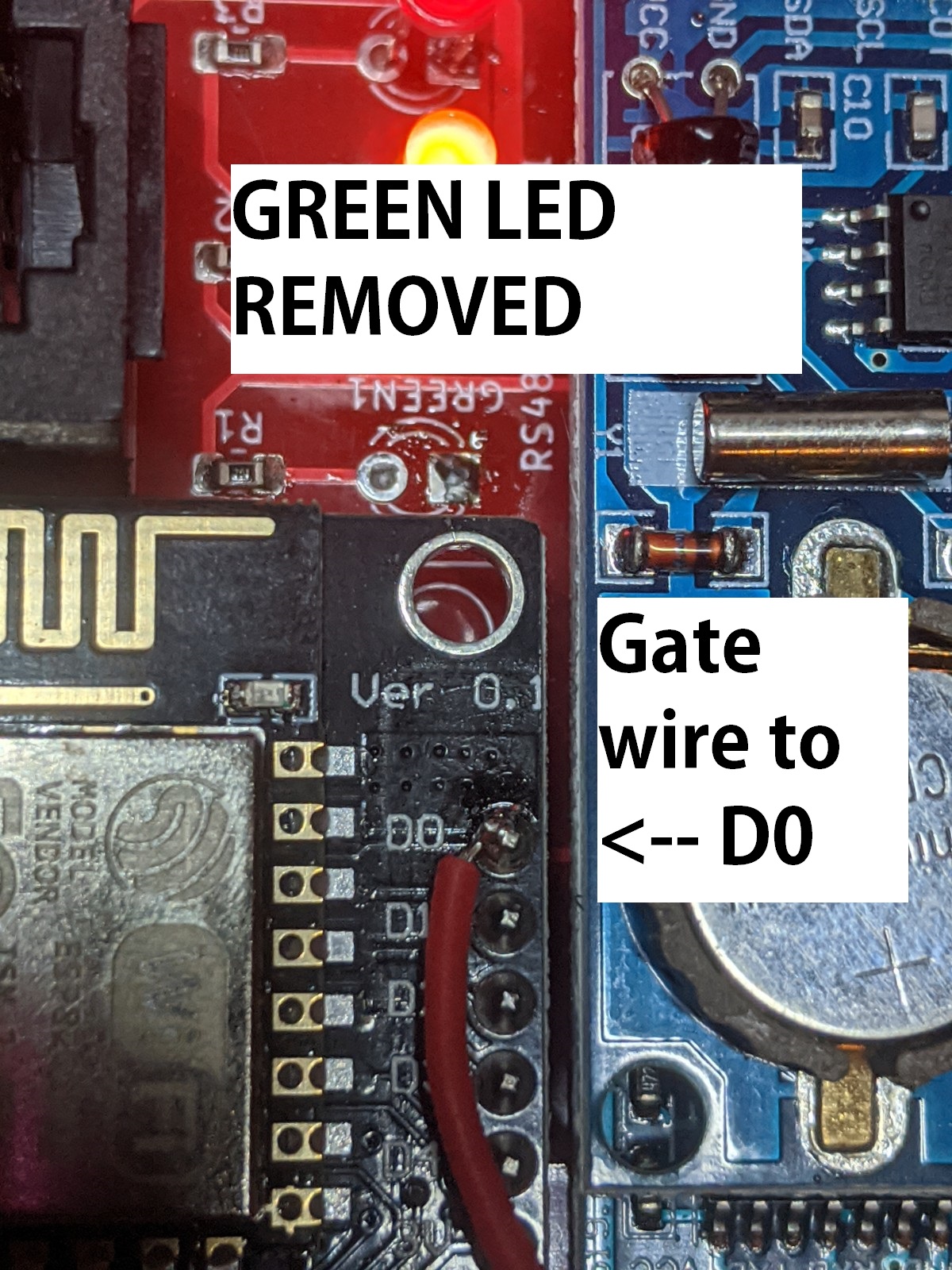

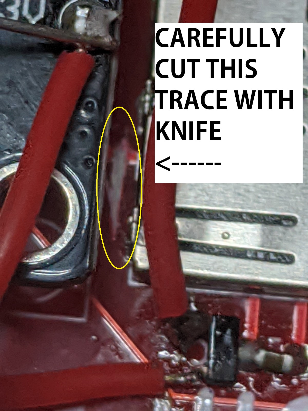

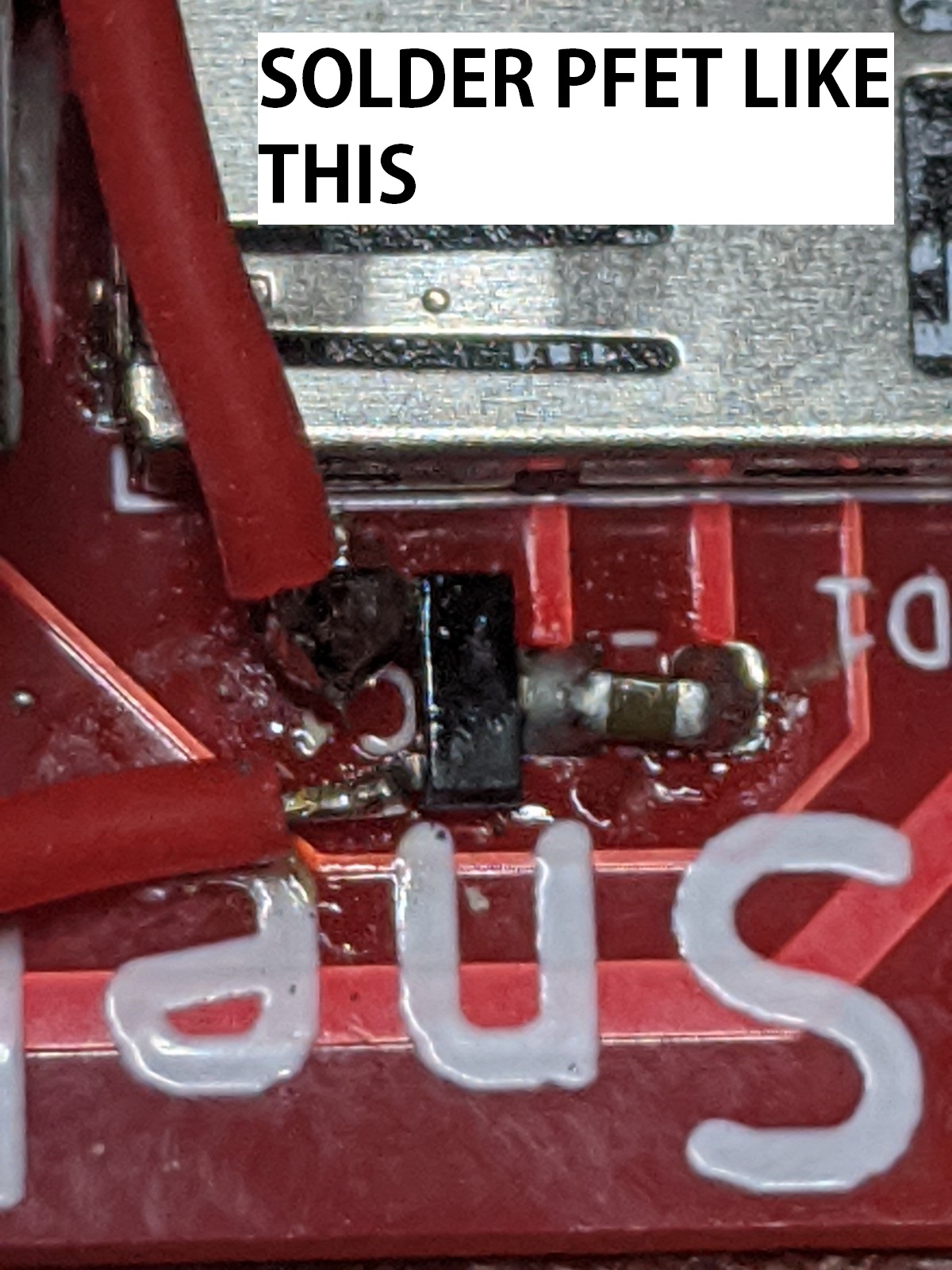

Hi Xion2000.
ALL ORDERS AFTER FEB 19, 2020 come with the upgrade pre-installed. No need for any of the below!
We are releasing V3.1 today. It fixes a bug that can cause the SD card to lock up and require manual reset. Unfortunately it requires a hardware update as well as the V3.1 software. You can use the V3.1 software without the hardware update but you won't get the benefit of the SD card auto reset.
See shop item:
https://www.snektek.com/shop/index.php? ... uct_id=127
Instructions:
1. Cut the SD card power supply trace with utility or exacto knife as shown in picture
2. Solder connections like in the picture

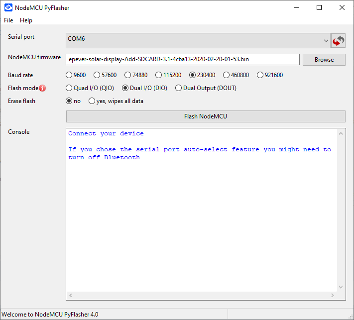

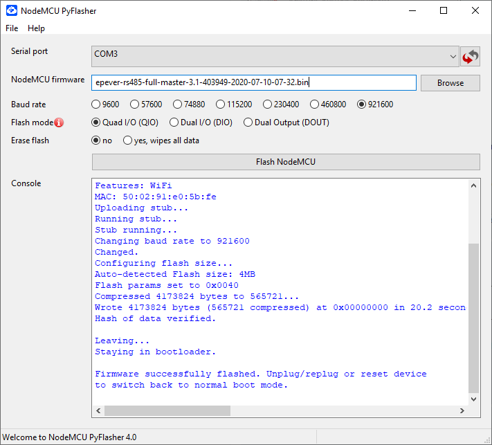

Instructions to upload V3.1 Firmware (Updated on July 11, 2020)
After this firmware is installed, new firmware is available by over-the-air update in the settings page
Requirements:
1. USB micro connector cable
2. Download NodeMCU PyFlasher from here: https://github.com/marcelstoer/nodemcu- ... .0-x86.exe
Instructions:
Step 1. Download and extract the zip archive:
Step 2. Open the case from the unit and attach a USB micro connector to the computer. Remove progjump1 and progjump2 jumpers.
Step 3. Open NodeMCU PyFlasher
Step 4. Select "Serial port" and click "Browse" to select the file: epever-rs485-full-master-3.1-403949-2020-07-10-07-32.bin, extracted from Step 1.
Step 5. Click on "Flash NodeMCU", and see the following output when successfully completed:
Step 6. Unplug the unit from the computer and place back inside the case. Replace progjump1 and progjump2 jumpers or there will be no communication with the solar controller.
Step 7. Navigate to the solar dashboard page and click the settings tab. Go the the firmware section and update the firmware to the latest. If no firmware update is available, click reboot to check again.
