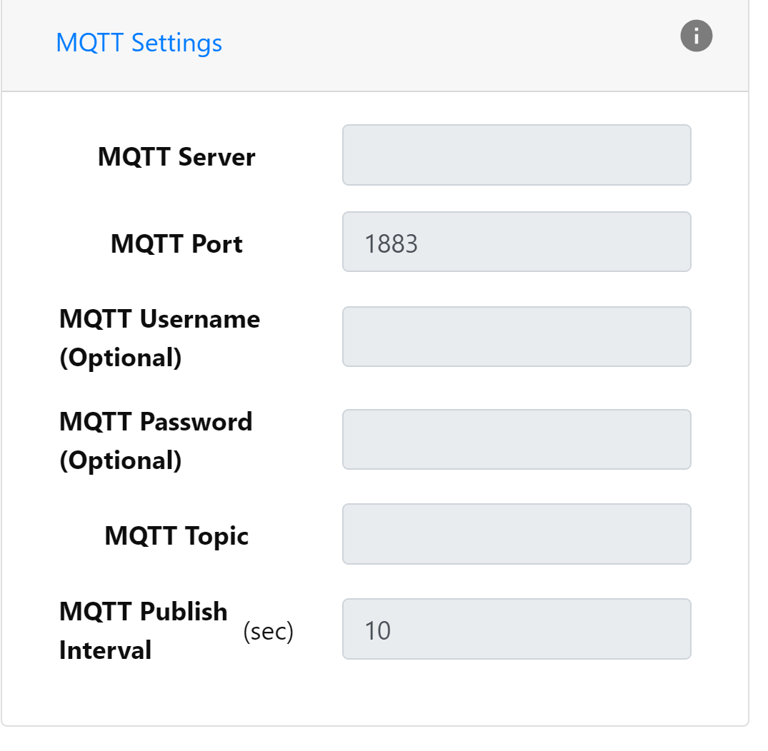

It's been awhile since I posted, Just looking at the setting for local MQTT data logging, and my MQTT broker uses a username and password to enable me to log the data from the solar dashboard, just wondering if or when there maybe a firmware update coming so as to log the data locally to my local LAN MQTT broker, I see this has been asked a few times, thanks in advance

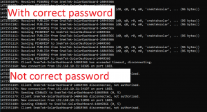

Hi Ross and others,
I have added MQTT username and password functionality to the solar dashboard firmware "8f539c-2023-01-01-05-43" available on the "edge" update channel. Please try it out and let me know if it's working well for you or if there are any issues.
