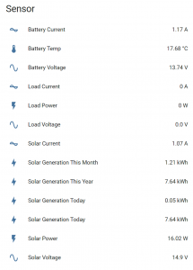

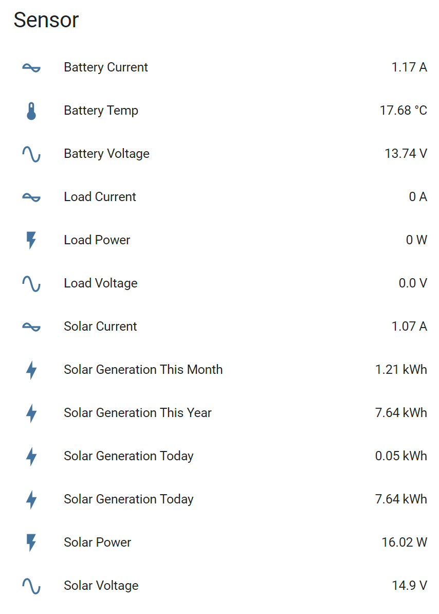

The Snektek Solar Dashboard can be used as a sensor entity on Home Assistant.
Add this to your configuration.yaml:
Code: Select all
### Snektek Solar Dashboard ###
rest:
 - resource: http://192.168.10.30/cur_data
   scan_interval: 5
   sensor:
     - name: "Solar Voltage"
       #unique_id: snektek_solardashboard_solar_voltage
       value_template: '{{ (value_json["pv.v"] | float -0.0 | float) | round (2)}}'
       device_class: voltage
       state_class: measurement
       unit_of_measurement: "V"
     - name: "Solar Power"
       #unique_id: snektek_solardashboard_solar_power
       value_template: '{{ value_json["pv.p"] }}'
       device_class: power
       unit_of_measurement: "W"
     - name: "Solar Current"
       #unique_id: snektek_solardashboard_solar_current
       value_template: '{{ value_json["pv.c"] }}'
       device_class: current
       unit_of_measurement: "A"
     - name: "Battery Voltage"
       #unique_id: snektek_solardashboard_battery_voltage
       value_template: '{{ (value_json["bt.v"] | float +0.04 | float) | round (2)}}'
     - name: "Battery Temp"
       #unique_id: snektek_solardashboard_battery_temp
       value_template: '{{ value_json["bt.t"] }}'
       device_class: temperature
       unit_of_measurement: "°C"
     - name: "Battery Current"
       #unique_id: snektek_solardashboard_battery_current
       value_template: '{{ value_json["bt.c"] }}'
     - name: "Load Voltage"
       #unique_id: snektek_solardashboard_load_voltage
       value_template: '{{ (value_json["ld.v"] | float -0.0 | float) | round (2)}}'
     - name: "Load Power"
       #unique_id: snektek_solardashboard_load_power
       value_template: '{{ value_json["ld.p"] }}'
       device_class: power
     - name: "Load Current"
       #unique_id: snektek_solardashboard_load_current
       value_template: '{{ value_json["ld.c"] }}'
     - name: "Solar Generation Today"
       #unique_id: snektek_solardashboard_gen_today
       value_template: '{{ value_json["genToday"] }}'
       device_class: energy
       unit_of_measurement: "kWh"
     - name: "Solar Generation This Month"
       #unique_id: snektek_solardashboard_gen_month
       value_template: '{{ value_json["genMonth"] }}'
     - name: "Solar Generation This Year"
       #unique_id: snektek_solardashboard_gen_year
       value_template: '{{ value_json["genYear"] }}'

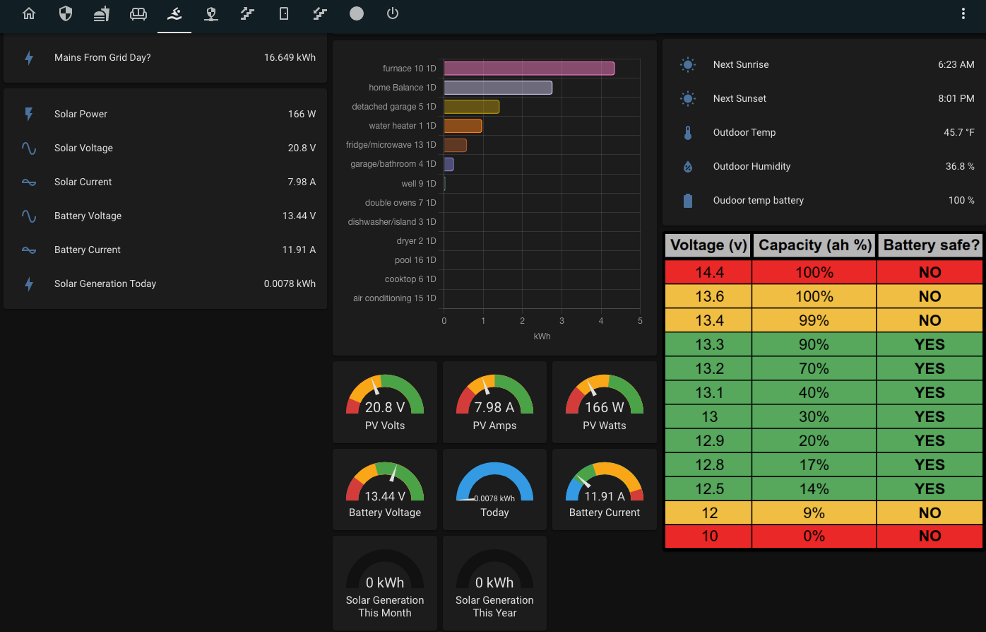

here is code in my home assistant dashboard for gauges. You would need to adjust severity values to fit your solar system but gives you an idea of display in HA I have a renogy controller so the Total moth and year sadly dont work.
Code: Select all
type: grid
cards:
  - type: gauge
    entity: sensor.solar_voltage
    min: 0
    max: 54.16
    needle: true
    severity:
      green: 25
      yellow: 7
      red: 0
  - type: gauge
    entity: sensor.solar_current
    min: 0
    max: 20.32
    needle: true
    severity:
      green: 10.16
      yellow: 5
      red: 0
  - type: gauge
    entity: sensor.solar_power
    min: 0
    max: 480
    needle: true
    severity:
      green: 260
      yellow: 115
      red: 1
  - type: gauge
    max: 14.4
    entity: sensor.battery_voltage
    needle: true
    severity:
      green: 13
      yellow: 12.5
      red: 10
    min: 12
  - type: gauge
    entity: sensor.solar_generation_today
    min: 0
    max: 2
    needle: true
  - type: gauge
    entity: sensor.battery_current
    needle: true
    min: 0
    max: 50
    severity:
      green: 10
      yellow: 20
      red: 45
  - type: gauge
    entity: sensor.solar_generation_this_month
  - type: gauge
    entity: sensor.solar_generation_this_year
columns: 3
square: false
