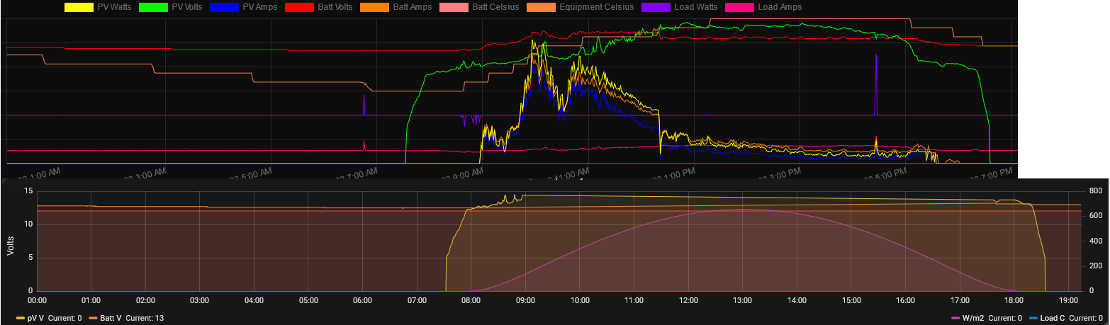

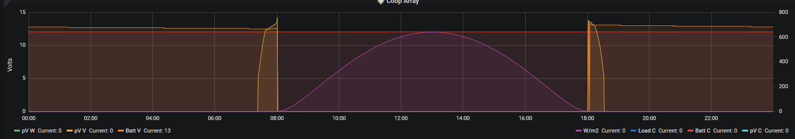

Matching the failure start and the dashboard, it happened today at 14v pV and 0.93w pW. MQTT stops right when the snekTek dashboard shows the charge controller starts charging the battery. It is a 100w panel connected to a Renogy Wanderer.
Attached are the Grafana/MQTT and snekTek dashboards for today:
Re: New firmware breaks MQTT
JohnH wrote:
Mon Jan 30, 2023 8:18 pm
Thanks John. I am testing a firmware that fixes the problem. The issue was related to a buffer that was big enough for low numbers but not big enough to contain many double digit numbers.
