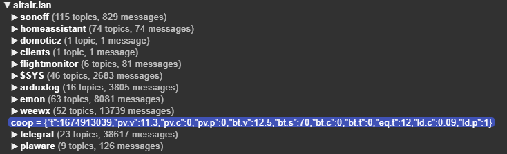

Caught it live. 3rd day in a row failing at exactly the same time.
Last measured MQTT values:
Solar: 14v
Battery: 12.6v
Load W: 1w
Load A: 0.08a
SoC: 74%
Other data from dashboard @ time of failure:
Internal Voltage: 3.486v
Controller Temp: 55.400000000000006F (lol)
SoC: 100%
Battery: 13.8v
Battery C: 0.77a
Load W: 1w
Load A: 0.09a

Dashboard is still updating properly while MQTT is failing.
TLDR;
MQTT is failing every day from 8:02am until 6:03pm every day, while the dashboard continues to update properly. The battery SoC is not in the "discharge danger" range at the time of failure and continues to charge properly per the dashboard.
My guess is if there isn't a coding bug that causes a failure based on the clock, it must be caused by the fact that the Sun is just starting to provide enough energy to charge the battery, and at ~14v pV and/or ~13v bV is triggering a bug. That must be why it is failing when the voltages get to that point, and when it automatically resumes when they fall below that point. Attached is the image from Grafana showing the failure/recovery trend. Disregard the horizontal red line as it is my low battery voltage alarm threshold. Also reference the purple line. That is the W/m2 from my weather station and you can see that it seems to support my theory stated above.

Matching the failure start and the dashboard, it happened today at 14v pV and 0.93w pW. MQTT stops right when the snekTek dashboard shows the charge controller starts charging the battery. It is a 100w panel connected to a Renogy Wanderer.
Attached are the Grafana/MQTT and snekTek dashboards for today:
