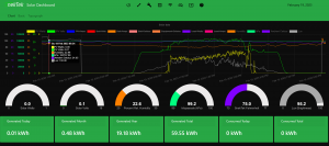

Hi everyone,
Today I can announce the SnekTek Solar Dashboard PLUS model. The PLUS model will feature 4 new metrics:
- Percent Relative Humidity
- kilopascals (kPa)
- Ambient temperature at the SnekTek Solar Dashboard
- Lux (Brightness)
We are going to use these metrics in the future to provide Cloud Intelligence Insights into your system, for those with a mysolardashboard.snektek.com Cloud Subscription.
For example, if the temperature is below 0 degrees C and the Lux is showing good sunlight, but the solar production is low, we can generate a Cloud Intelligence Insight indicating that the panels may be covered by snow. Snow Cover can also be estimated in Real-Time and displayed on the graph as another metric.
Using the Temperature, Humidity, Pressure and Lux sensor we can estimate the weather conditions as well, maybe combined with internet weather forecasts and reports if available.
The SnekTek Solar Dashboard PLUS model is now available to be optioned (pre-order) on the shop at https://www.snektek.com/shop/SnekTek-So ... Compatible
Expect shipping by March 20th.
Let me know your thoughts on this.
The Sensors used are the Texas Instruments OPT3001 and Bosch BME280
See screenshots Below:

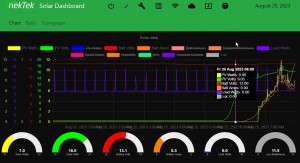

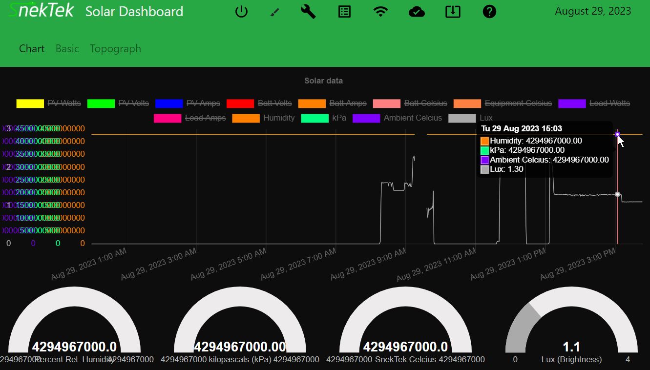

Since my Snektek monitor just arrived last week I can assume it's the "Plus" model.
These extra sensors don't seem to have valid values, except Lux.
(See attached screenshot from moments ago)
Speaking of Lux, when I first setup the SnekTek into my Renogy 30A MMP I noticed the Lux value did change with ambient 'brightness' and was not sure where the sensor was. Since the garage has windows the Snektek unit would get sunlight. However, just lately I rebuilt my system with 2 panels on my roof and the Renogy & Snektek in the basement.
I noticed that when I was working on the system, I would have the basement lights on and got an almost constant Lux value (some sunlight gets in too). However, I quickly realized the Lux sensor must be in the Snektek unit since the value shown varies whether the basement lights are on or off.
As comparison a screen capture from a few days ago when the unit was in my garage and sunlight starts to show around 6:30.
Is there calibration needed for the other sensors?
- Ron

Hi Ron,
I'm glad you're enjoying the unit.
You ordered the regular model, the plus model is available on the website as a drop down option. However I send you a plus model with a working light sensor only. I got a batch of plus models where the environment sensor is not working so I send you the plus model with the working lux sensor as a bonus. The sensors are next to the SD card slot see if you can find them!
Jonathan

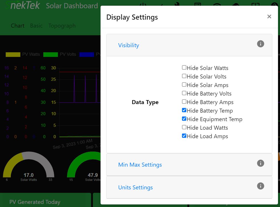

While the LUX sensor does work, it's not needed in my setup.
The dashboard DISPLAY SETTINGS (see pix) allows easy config of data types to be hidden (not needed for display). However this list has only a couple of the Environment settings.
Could the following be added:
Humidity, KPa, Ambient Celcius, Lux
These settings are stored in the browser according to the info. Is there any config file on the SD card that would make that semi-permanent?
Thanks,
Ron

Yes this needs to be added. Next update
