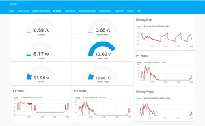

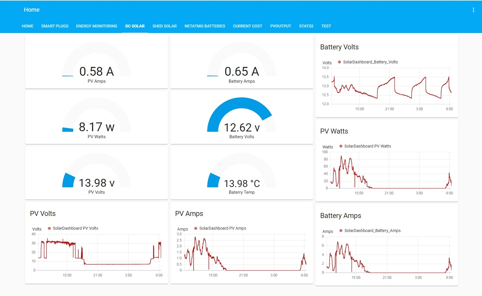

I was using my integration in conjunction with a DIY DC only Solar OFF Grid project and using Home Assistant and the SolarDashboard to enable a battery charger to switch on automatically when the combined battery voltage of a bank of 3 12v batteries got down to a certain level (12.4v).
I have 2 computers that run 24/7 that are located in my garage where the Solar Charge Controller and the Batteries are also. I've been dabbling with some off grid usage and was trying to run the PC's (+ a 4 Hard drive caddy) using a small array of Solar Panels (270w).
If the weather was decent each day the batteries would recharge sufficiently to then power my equipment through the night as well as through the day but if the weather was not (I'm in the UK!! and it often isn't) the battery charger would kick in as a secondary power source until the batteries were back upto a certain voltage.
So I only actually required the battery voltage data from the SolarDashboard but having the other data displayed in Home Assistant was a nice to have.
