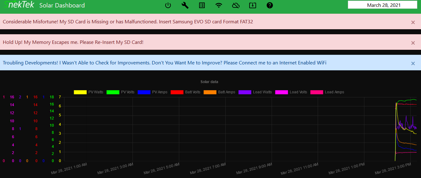

I have tried 2 Sandisk (16 and 32GB), 1 PNY 8GB, and one 8GB Kingston SD cards, and all result with the web interface saying there is an error and that I need to insert a Sandisk EVO. They were all formatted FAT32 with both PartitionWizard and Windows10 native formatter. I ordered a 32GB Samsung EVO card today. These messages go away when I power the unit without an SD card inserted. It is powered via the Wanderer for all of these tests.
Here is a sample of a log:
[sd_card]: No SD-card. 28-03-2021 01:25:02
[sd_card]: Error: SD Card malfunction, sample write failed 28-03-2021 01:25:02
The unit also won't send to MQTT unless the card is removed. The publish period is set to 10s, although it is intermittent and may only publish every several minutes with no SD card.
The unit reboots every few seconds to every several minutes, or once every few hours with the SD card inserted. It is now over 30 minutes running without the SD card inserted without rebooting.

SD card issues
While you would think any reputable brand SD should work, we have found only certain cards work, and some work intermittently. We are looking at porting to another SD library in the software, but we have dependency on the espasyncwebserver library. So it's not trivial.
This is why we HIGHLY recommend the Samsung evo cards to avoid this struggle. Luckily they are readily available worldwide.

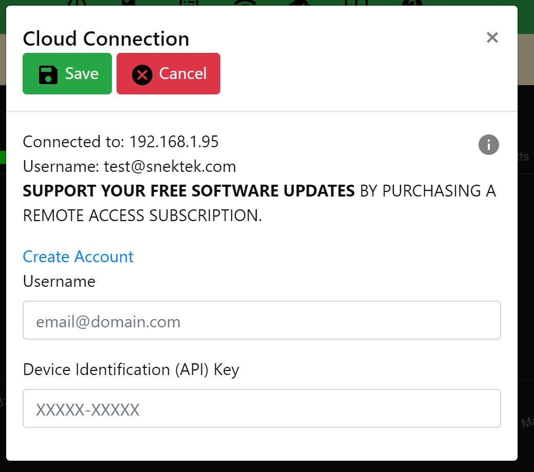

No errors in the web log either!! Great product and support! I entered the API key into the config but the progress circle just keeps spinning. I left the username blank since it wasn't supplied.

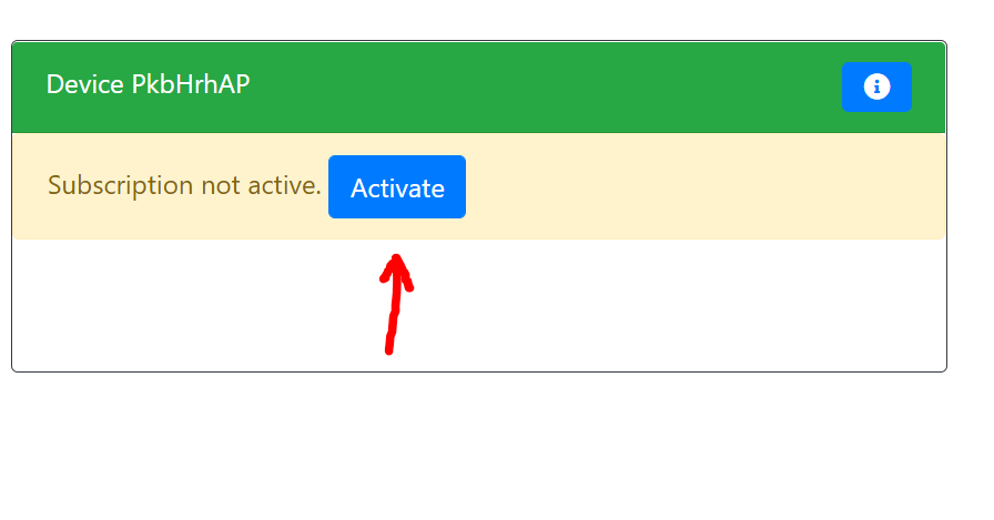

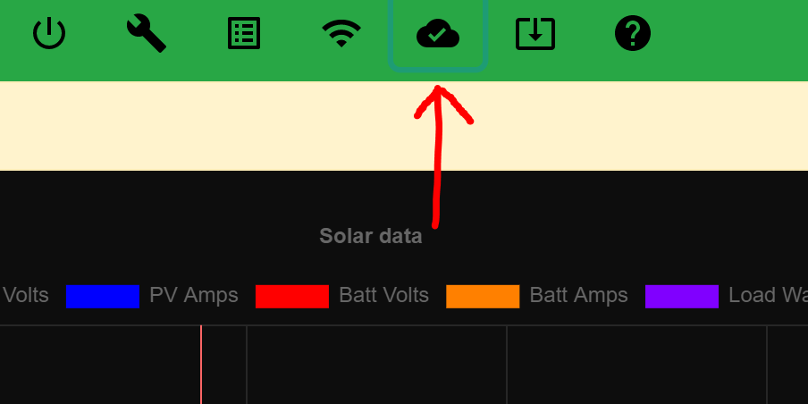

To use the cloud, make an account here: https://mysolardashboard.snektek.com/signup

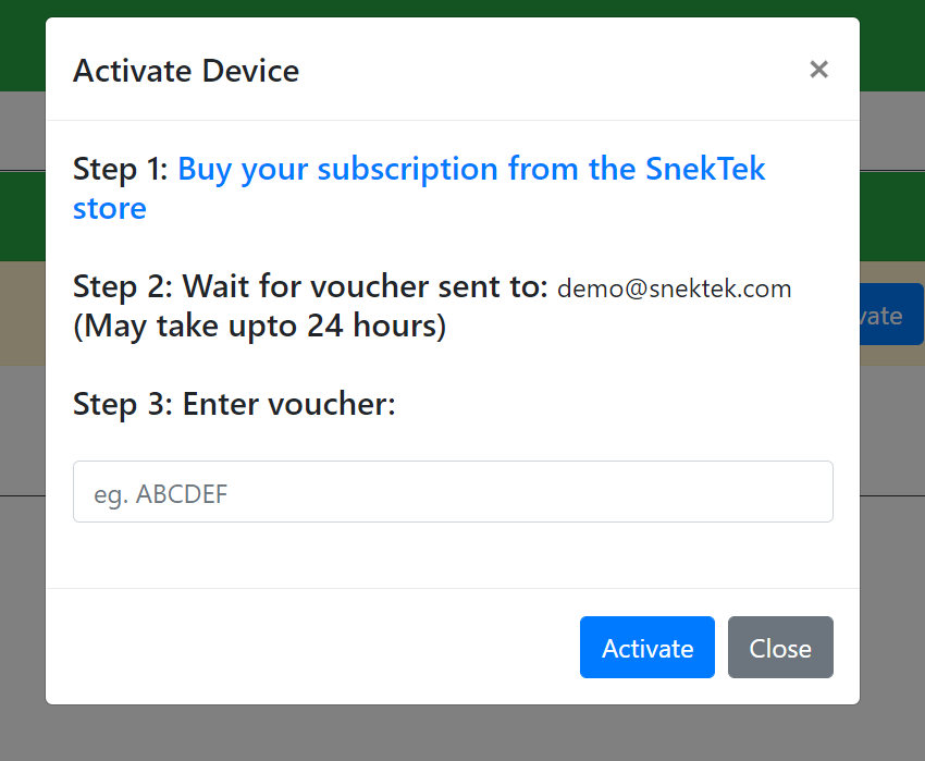

Then enter the voucher I sent you into the virtual "device" where it says activate.

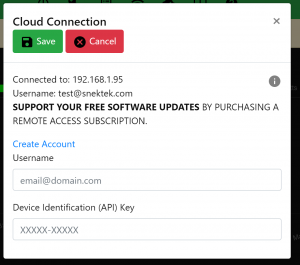

Then use the API key that it shows and enter that in the dashboard locally. Use your username from the cloud account.

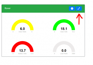

Then head back over to the https://mysolardashboard.snektek.com and you should see this:
Push the arrows to expand to full dashboard.
