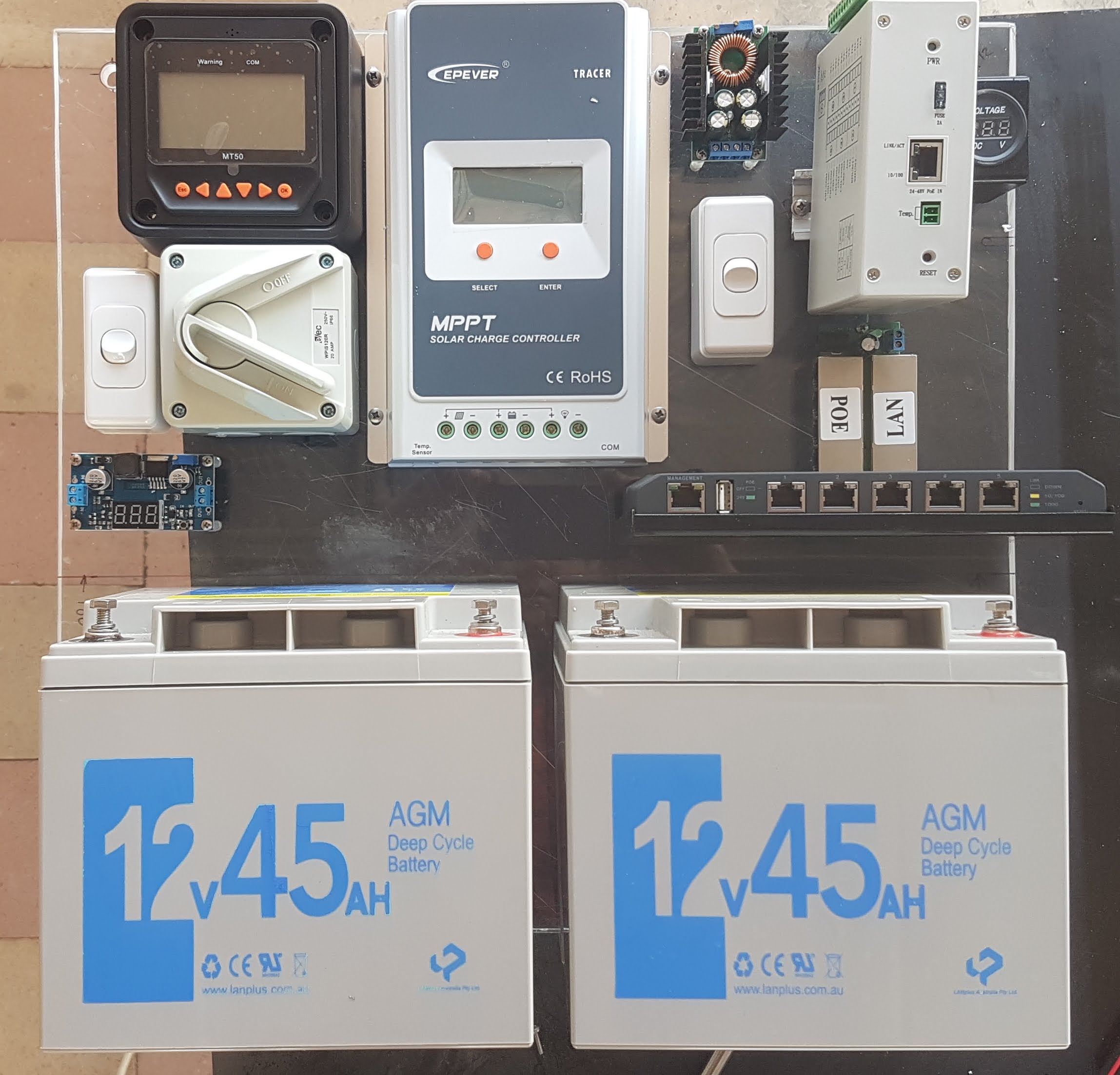

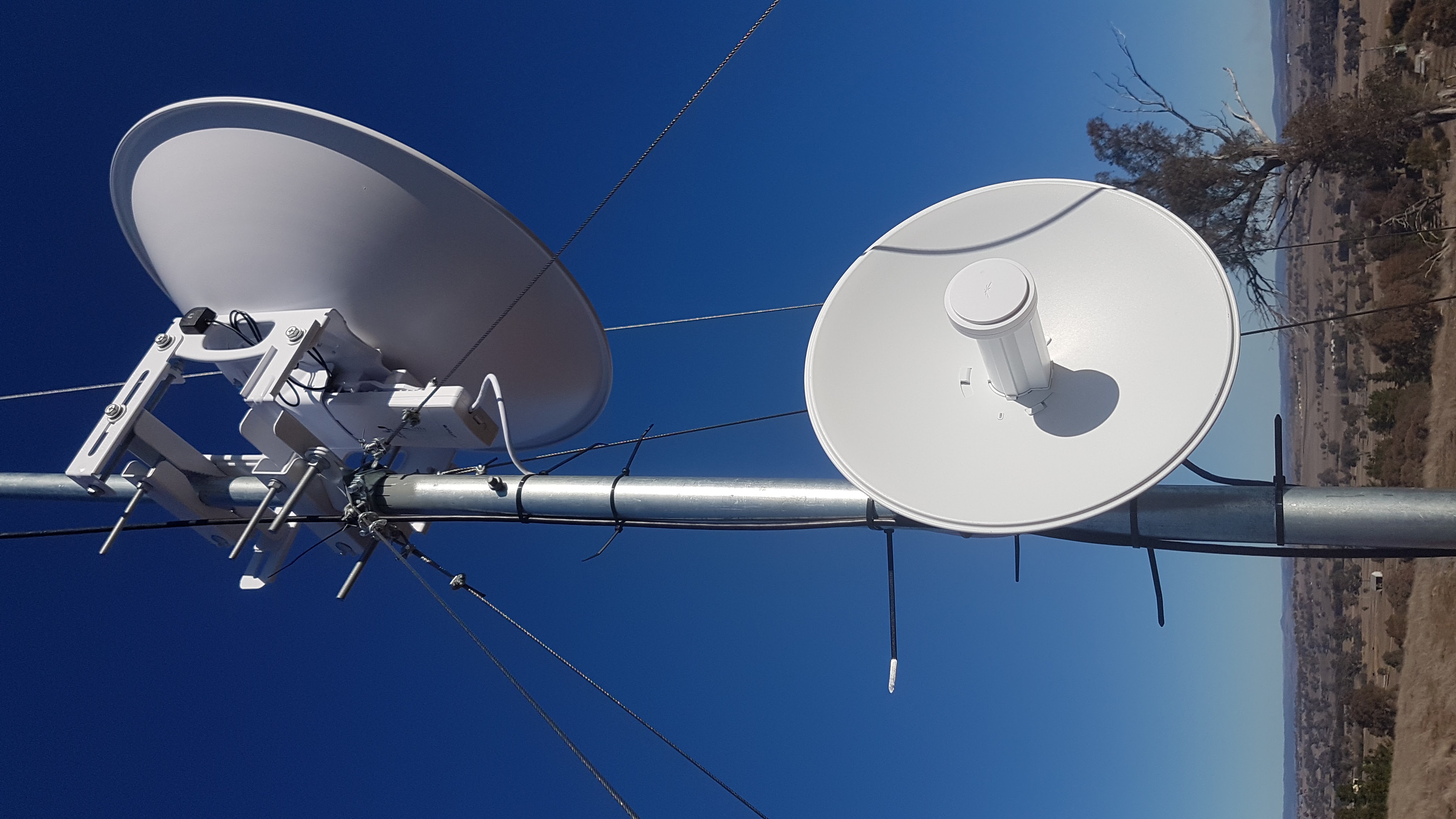

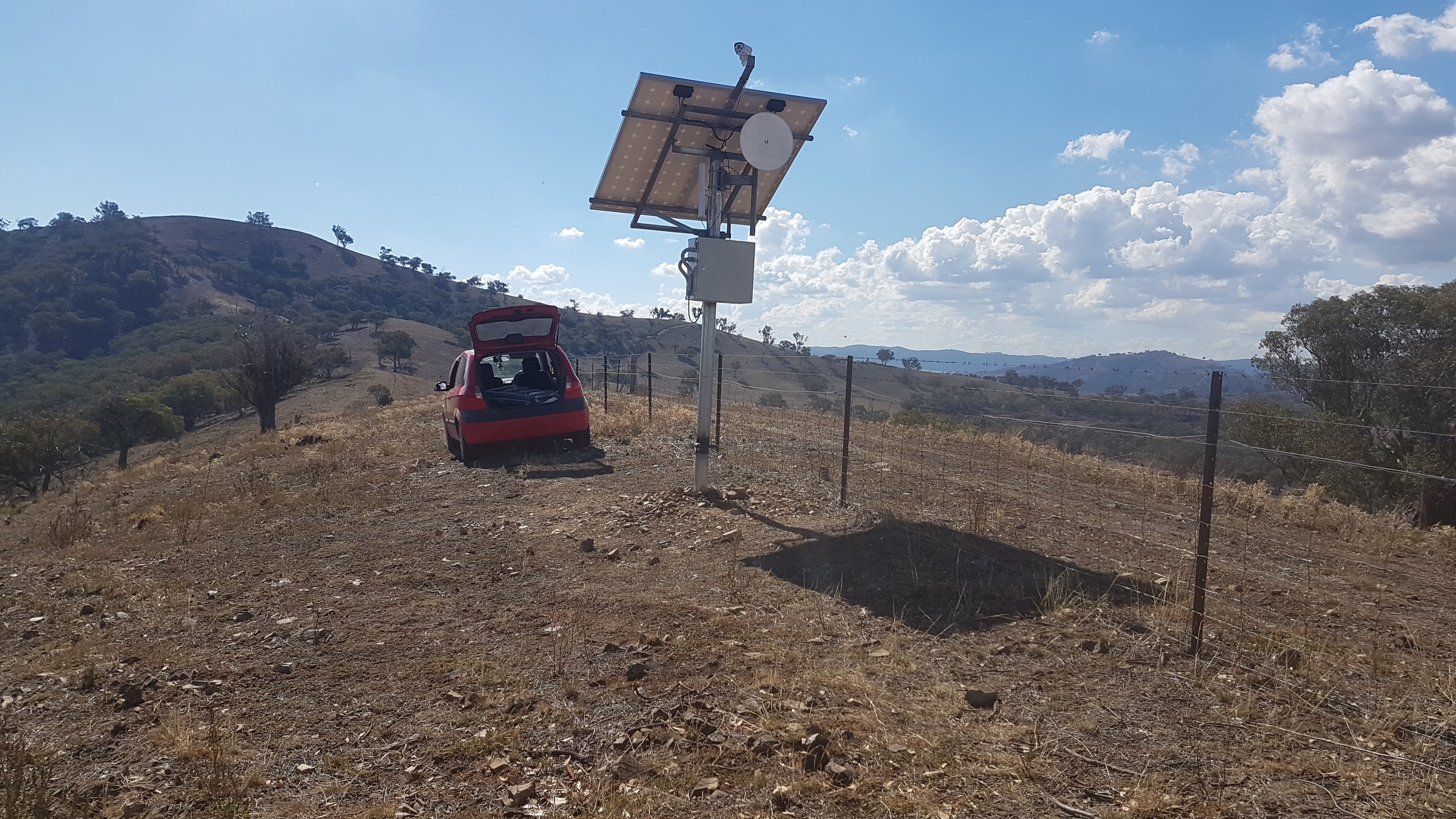

I have received my solar dashboard which is to be incorporated into a solar powered wireless relay stations upgrade running ubiquiti gear, as this setup uses 24v battery (2x 12v batteries in series) setup I am unable to show the battery voltage that only peaks at 16v on the web interface, is there anyway of getting the code to show up to 32v in the battery graph and dial
https://youtu.be/6ZA1O2FoXEE
https://youtu.be/M8tYr6S6kqg
Hi Ross, Amazing setup, thanks for sharing.
I had some time today to work on the software and I attached a modified software for your use in your sweet relay.

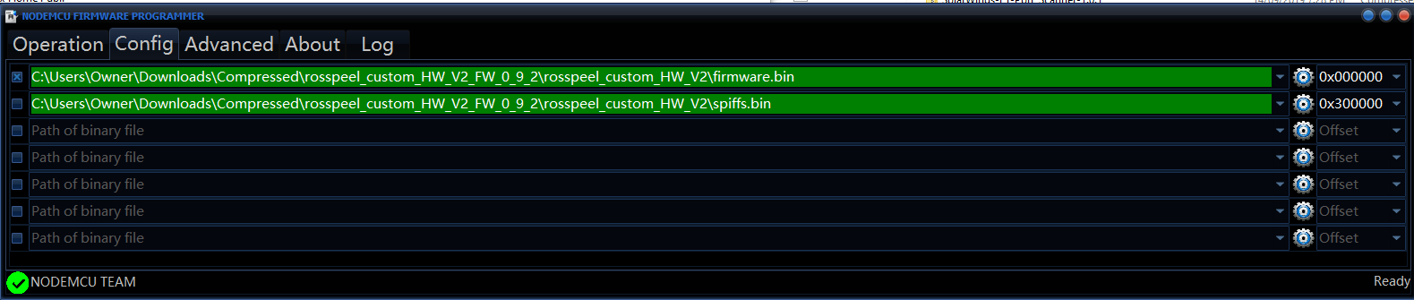

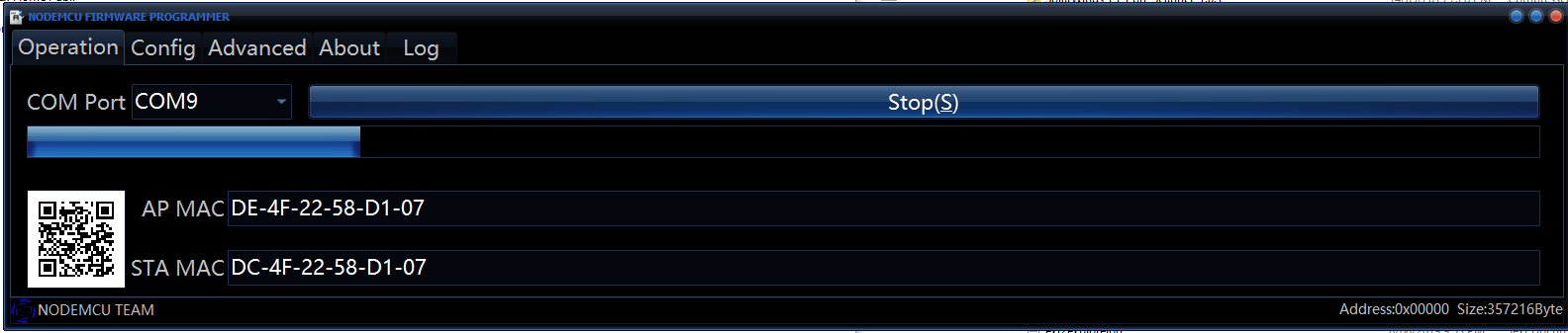

This may be a dumb question, but have been around in circles for last 5 hours trying to find how to Put ESP into bootloader mode with a windows machine, lots on a Linux machines and use terminal commands and lots of confusion.
Ross
rosspeel
Posts: 15
Joined: Fri Oct 04, 2019 7:24 pm
Location: Peel, NSW, Australia
Contact:
Post by rosspeel »
I have used a different program to flash, it seemed to go ahead and flash, but i am not getting a 24v battery reading, still showing 12v system (16v), I now have my LEDs flashing in a orderly way now instead a 3 constantly on
Also the links on your update Software Version 0.9.2come back with a reply "That link has no power here Return to the previous page or go back to your dashboard"
"Software Version and links added to HTML", the "rosspeel_custom_HW_V2_FW_0_9_2" i flashed seemed to not show any Software Version number on the web page
