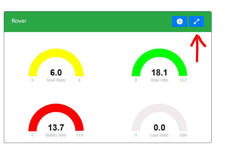

Then head back over to the https://mysolardashboard.snektek.com and you should see this:
Push the arrows to expand to full dashboard.
