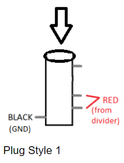

Looking at your pictures I see two issues:
1. Did you cut the ground plane completely on the PCB? It looks like you need to cut a bit deeper to sever the electrical connection. Use a multi-meter to confirm. Cut both sides completely.
2. It looks as though you have wired the headphone jack incorrectly. the two red wires should be connected to the two pins furthest away from the input of the plug, see pic: Let me know if this fixes it!

Thanks for the reply.
Unfortunately neither suggestion fixed it, so I took to using some troubleshooting skills and narrowed it down to the wires on the switch. I don't know why, but that's what was causing it to short out. After painstakingly trying to resolder the wires back onto the switch and having it again not work, I decided to completely sever the speaker from the internal plug, so it's only running a 3.5mm out now.
Hope others have more luck!
