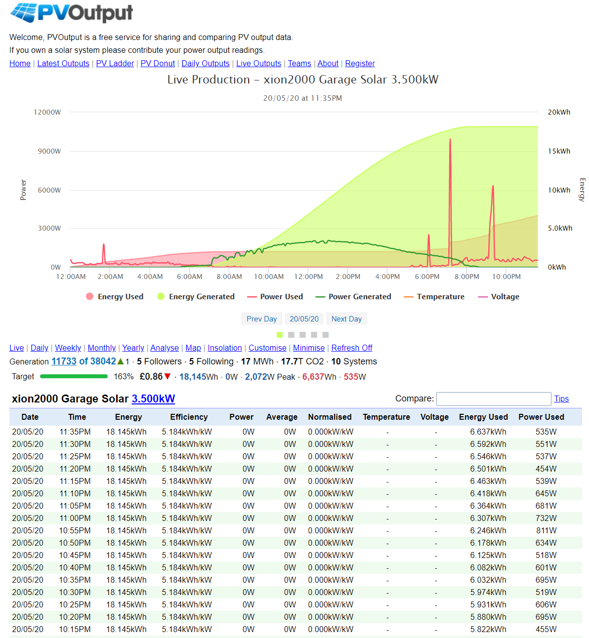

Eventually got the components to carry out the fix on the SolarDashboard and my friend carried it out for me. So now I have constant monitoring of my system which is great!! I have noticed that the reboot count continually increases at rather a fast rate and I have been looking at the web interface when it appears to crash / go off for a second then resume monitoring, is this the norm, a problem with my system or a known issue you are working on?
On another note, I too have signed up for the cloud service. I'm not sure if its something I will use much but I thought for $20 and to support the project why not!
I already import the data into home assistant which can easily be accessed on my mobile phone but unfortunately not on my work PC (very tight restrictions / security) and I've forwarded a port for the dashboard but can't access that at work either so I'm hoping the cloud service WILL be accessible (if it can't be its not the end of the world)
I like to closely monitor my ever increasing solar and energy monitoring setups which have been slowly growing since I had a professionally installed system fitted on my East & West facing garage roof (I'm in the UK so South is best if possible then East/West).
https://pvoutput.org/intraday.jsp?id=13 ... t=20200507
https://pvoutput.org/intraday.jsp?id=13236&sid=11144
